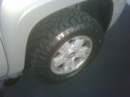

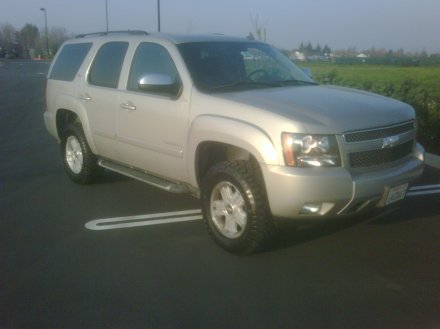

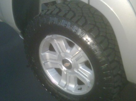

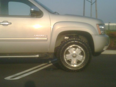

Here are some Goodyear Duratracs (275/65/18) on stock 18" Z71 rims w/Bilstein 5100 front leveling shocks.
