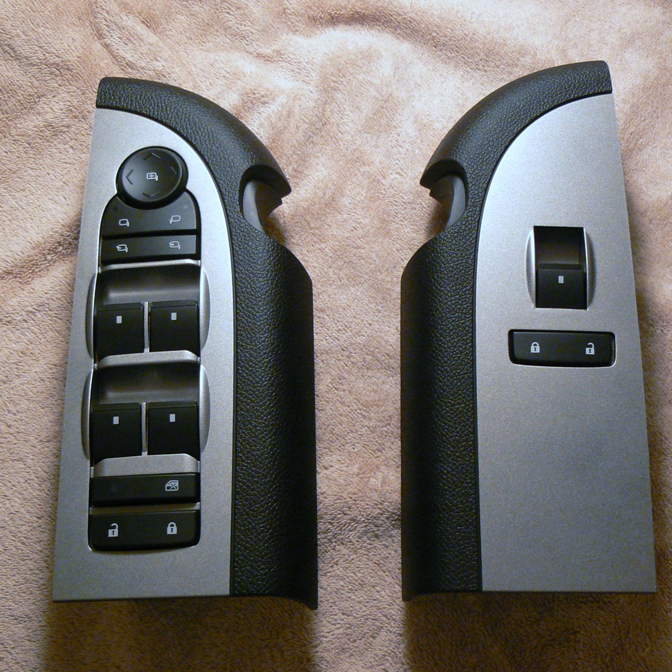

To answer you question, yes , it should be an easy swap. Your truck most likely came with the fold in mirrors being an LTZ, and the previous owner upgraded to the tow mirrors. If your driver side door has a switch that looks like the one on the left (I borrowed a picture from the for sale forum), then you are ready to go, and I don't think you will need to have the dealer program anything into your truck.My advice, just check the for sale forum on here, Craigslist.org, local dealer, or Ebay, and see if you can find a good set that matches your truck, and you are good to go. Easy DIY project.
edit: I forgot to attach the pic.
I don't know why they just don't leave the original door folding switch part there. They did in my truck. I just cant fold the mirrors in for HD mirrors that's all.
