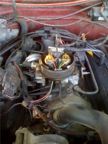

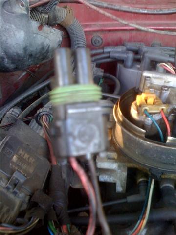

well its 5.7L engine and while looking at the engine i noticed a connector that wasn't plugged into anything and i couldn't find a female end to plug it into. attached should be the pics of what Ive found. now as for reading the codes i thing i found the ecm fuse it says ecm ign but im not sure of what box your referring to that i have to jump the two points at.
I don't recognize that connector, do you have an air pump on yours? Might be for something related to that or something else I don't have on mine.
You should be able to move it around as far as the leads go and find where it goes unless the thing it plugs into has been removed from the truck.
