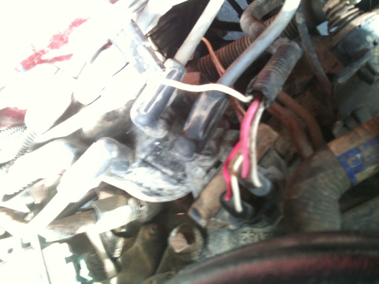

Is the ignition module something i can buy at an auto parts store or is this something i'm going to need to order? I took a picture of what i think it is, let me know if i'm on the right track. I'm thinking it is the one with the 2 sets of white & red wires in it.

that's your coil.

WELL, i'm not sure if this is the whole problem, but i'm sure it's part of it!
...but this still doesn't explain why i have no spark coming off the coil.
This looks like a job for...someone much more mechanically inclined than I!!!
Time for a new dist.,your looks like it self distructed...and rusty.Actually distributors are not that hard to change,but there are some dos & don'ts.There are threads here that can you show how it's done.Try a search,I'm sure you'll find one :)
