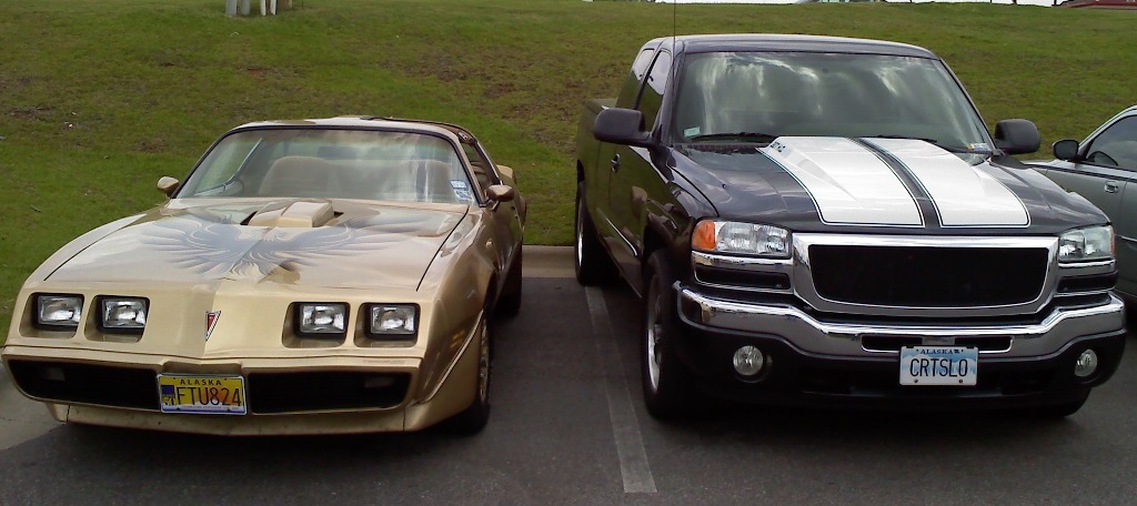

Here's a picture of the truck, next to my '79 T/A
Your transmission will last a little while, but if you start beating on the skinny peddle, your weakest link will be the transmission. I'd certainly consider some upgrades for the transmission :lol:

How did you do that ls swap into a 50 model sierra in the first place? Just get it tuned up good, and increase the line pressures and maybe beef the tranny up, depending on how hard it's going to be used.
Sorry, not '50, I meant '05. I typoed the hell out of that, lol.
