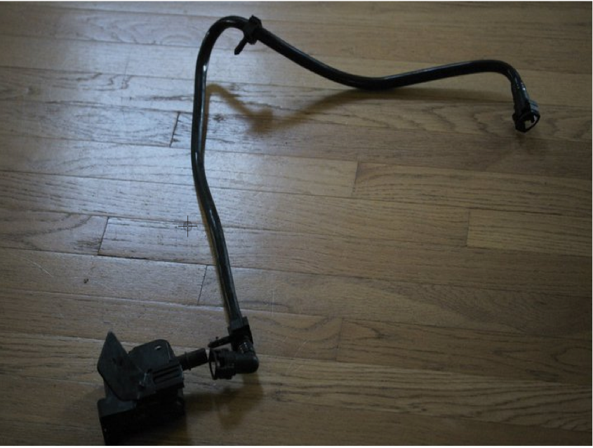

The replacement part (AC Delco #214-2081) looks a bit different but is supposed to fix the problem from happening again.

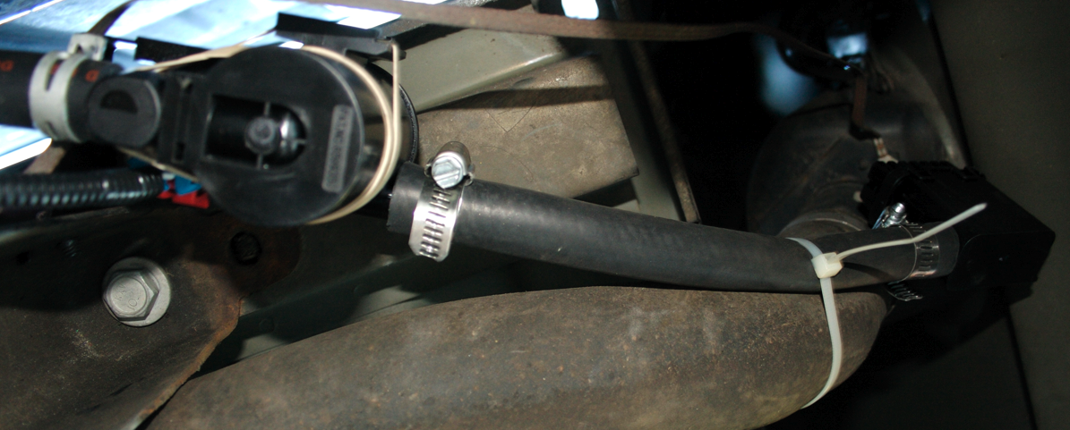

If you search for evap vent valve solenoid on this forum you will find a lot of information on this topic and I just wanted to add some more pictures and the way I hooked everything up. I don't see the point in hassling with the transmission and using 5 ft of heater hose to relocate the vent valve box. I just zip tied it to the gas fill hose and it is out of the way and not near any heat sources. Thanks to everyone who has posted their information it really helped me out.

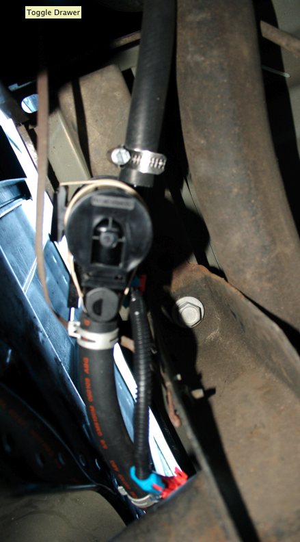

This is the new solenoid bolted into the same bolt that the old one came off of. It is a different bracket that repositions the solenoid on the outside of the frame instead of inside where there is no room.
