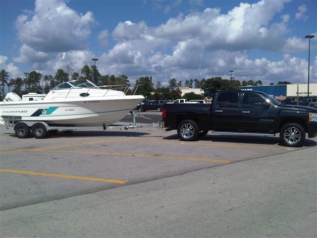

Last weekend I purchased and picked up a walkaround cuddy cabin boat. The boat weighs a little over 5000# and I had to tow it 300 miles back home. With this being said I knew I would know if I liked my 3.08 gears. Here is my set up:
2.5" Leveling kit
3" Blocks in the rear
33" Cooper Zeon LTZ
Gas mileage running 75 to get the boat was 17.1mpg.
Hooked the boat up to the truck and it squatted the truck down 1" to make it perfectly level. We took off and headed home and I told my wife this will be the test for these 3.08 gears. From the take off the truck seemed to have plenty power and showed no weakness pulling (tow/haul button on). I never pull anything in overdrive so of course it was M mode 5th gear. As we were driving the terrain was really hilly and the gears did not like it. On steep hills the truck would kick down to 3rd gear but on some of the mild hills it would drop to 4th. Now I had a 5.3 with a 4spd and when I would pull a camper up a steep hill it would kick down to 2nd gear and I must say it wouldnt sound right. Not the case when the 6spd would kick down to 3rd. I will have to say I still wasn't inpressed with the gears while pulling in this kind of terrain. Once we were getting closer to Houston and the terrain was more flat, the truck performed very well. I was running 65 to 70 mph the whole trip back. So to keep this short, my own opinion with this set up it is:
-For where I live and will be hauling the boat to, the 6spd w/ 3.08 gears performs very well and does everything I expect it to do.
-If hauling and the terrain is hilly or mountain areas, your going to want to add a different set of gears.
BTW: I was getting 10.3 miles per gallon with the load.
Heres a pic of the combo

Oops, meant to ask about the lift. Do you rub at all with the 2.5/3" and 33s? What about offroad? Was there any major change in the ride? I've been thinking about doing 2.5/3" and maybe a 1.5 or 3" body lift, but im really spoiled by this new frame and z85 suspension. Don't wanna lose the nice ride quality! How much rake is there with your combo and no trailer? What suspension package do you have(Z85, Z60, Z71)?
No rubbing with the set up but I am running 275/60/20 (20 x 8.5" wheel & 18mm offset). You do lose a little ride quality but nothing that makes a huge difference. I love the look and am thinking about adding a 1.5" body lift. Not sure about the suspension. I did get some rake back when I added the blocks but I had to have it in order to tow. Here are my fender measurements:
Front: 39.5"
Rear: 41.5"
