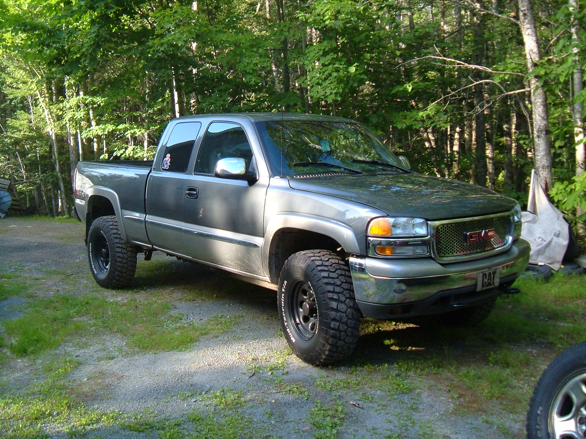

It calls for 245/75-16's. I need tires and am thinking of going with 265/75-16's. It had 285/75-16's when I bought it and that was too much tire to push. I put some used 265/70-16's on it (about same diameter as 245/75-16) and it has much more get up and go. I suspect better mileage too. I'm mainly concerned with towing ability and mileage, but I'd like the little bit of extra clearance from a taller tire. I'm actually considering two sets of tires - 265/75-16 highway tread for spring and summer, and 235/85-16 mud terrain or similar for hunting season and winter. I already have the extra wheels. Thoughts? Thanks
if your truck is not programmed for the tire size it will throw your shift points off,speedo and mileage along with a few other things...keep that in mind
I had a set of 235/85/16`s on my 94 Sierra with 3.73`s and they were great, worked excellent in snow, didn`t have the tendancy to ski like the wider tires, my 01 Sierra had 265/75/16`s and 3.73`s when I got it, worked great, like jro909 said you should get your speedo calibrated for the 265`s as it will change things a bit, once set for 265`s you could run the 235/85`s as well as they are the same diameter.
