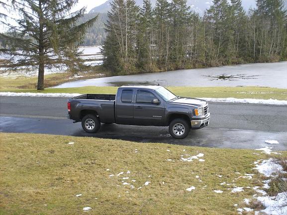

what are the biggest and widest tires and rims i can fit on a 2010 gmc sierra 1/2 ton with just a 2inch level kit. please and thanks!!!
Wheels need to be 9" wide and +18 offset
Big looking tires would be wide 305/50/20
Tall tires would be 275/60/20 or 285/55/20

I have an 08 Sierra with a 2" leveling kit in the rear (provided by rear lower shackles). Currently I have 22" rims with 305/40 tires. They definitly clear in the rear and front. You might be able to go a little bigger but the front is where you are going to have rubbing issues if you go to big.
this topic is beyond beat to death..
305/50/20 with +30 to +18 offset wheels. You CANT clear 305/55/20s only the 50 series.
If you want to do 22's, there is a guy running 33x12.5x22s with the OEM 22" wheels and it clears, but dont try 33x12.5x20 cuz it wont clear. I honestly dont know how the dude with the 33x12.5x22s clear its a divine miracle.
