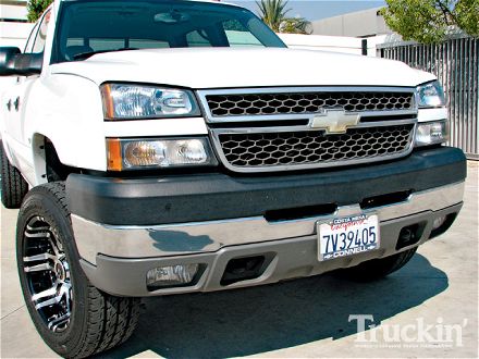

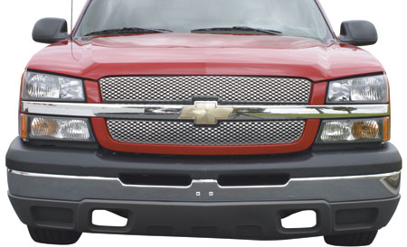

I recently bought a 2005, 1500 Z71 and I love it. But, I was wondering if I could swap the grille out for ones like they had on the 06 and 07 classics. I thought the 05s would have that style grille because my dads HD had one, but I guess it was an HD only option in 05. It looks like I might need a hood swap, but it may just be the pictures I found. Im not sure.
The first picture is like the grille I have, the second is of the style grille I want.
You would need a new hood for sure and maybe some parts between the grille and core support.
No, I helped a friend do an '03 using an '07 classic salvage truck. We pulled the hood, and the front grille piece and popped it right into the existing mounts. the only thing we ended up swapping beyond that was the housing for the lights (his were faded and nasty looking). fenders looked ok. I would assume that it is exactly the same as the '05 to '06.
