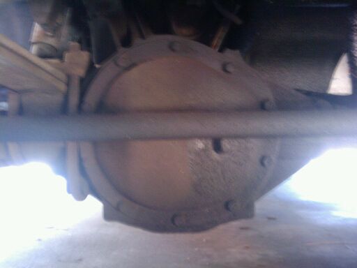

So I was recently given this 1990 Suburban V1500 4WD 5.7L and I love it, my aunt drove it every sunday to church and back, however at some point the left front bearing blew and now it needs a new spindle, I looked at the differential and it looks like a DANA44 however when I called a 4x4 place and asked him if he had the spindle for it he said he doubts it is a DANA44 and would NOT tell me what he thinks it has, he said "i know what diff that is and I can get you the part for $120.00 and unfortunaly I can't tell you what that is, if you want it I have it" which I thought was a douche thing to do, so I need help in finding out what differential is stock on a 1990 Sub, and what is the difference between a small and big bearing spindle?? thank you very much!!!post-89671-1298395597.jpgpost-89671-1298396044_thumb.jpgthis is what a axle ID chart told me a DANA 44 looks like and this is what I have under the truck
yeah I just looked at a zillion pics and came to that conclusion also...
Thank you very much for confirming
