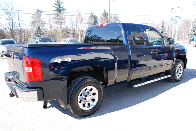

:( Hi,
Firstly, please bear with me since I am new at this forum.
I just bought a new 2011 Silverado 1500LS Extended Cab 4X4 Cheyenne Edition. It has a 4.8L with a 3.42 rear axle. It came equipped with Trailering Suspension (Z85) and Towing Hitch with Transmission Oil Cooler, all factory installed.
At the dealership, the salesperson had told me that it had a towing capacity of 7000lbs which to me was more that I needed. Note that I am pulling a 3300lbs boat (trailer included) sometime for distances of approximately 250-300miles. However, I am now unsure of this salesperson statement. Specially since the Gross Vehicle Weight Rating (GVWR) is 7000lbs. At the time I took his word for it but now realize that perhaps I should have done more homework before! Stupid me!
I have been looking at GM/Chevrolet charts which discuss maximum towing capacities for all types of vehicles. However, I have been having difficulties finding the information based on my situation. Most charts that I’ve seen refer to 5.3L with 3.73 rear axle and those which refer to a 4.8L with a 3.42 rear axle do not make any mention of Z85 suspension & factory installed transmission oil cooler. Lastly, would the towing/hauling mode help towing on highways.
I would appreciate if someone could provide me with their views of the towing capacities of my vehicle. Would the suspension & Trans. Oil Cooler raise this 5500lbs towing capacity.
Thank you in advance for any input you may provide.
