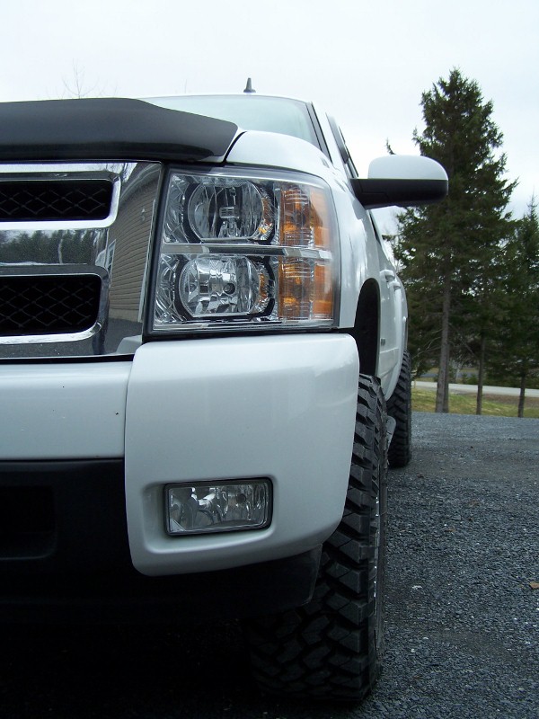

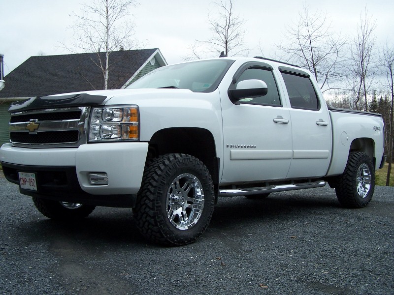

how did those 285's fit with the -12 offset? just curious cause im wanting the same tires with -4 offset.
They fit great but I did raise the truck 3.5" and I had minor rubbing on the mud flaps..a little trimming fixed that!!
