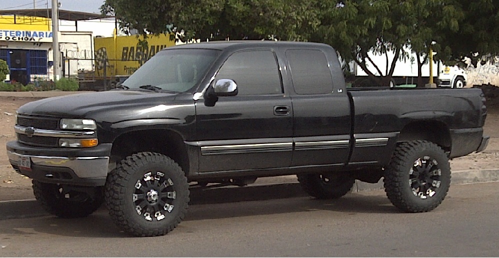

You have a kick ass truck from what your description says, can we get some pics please? And maybe a youtube vid of the exhaust?

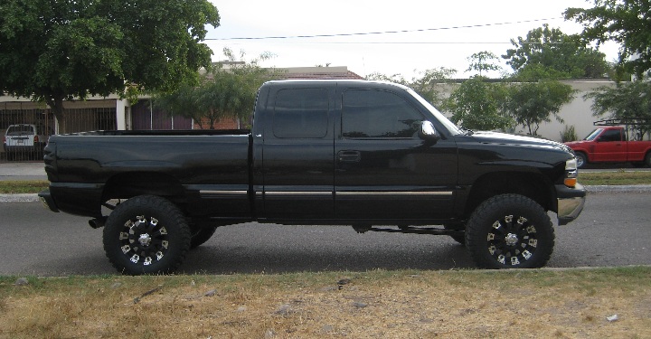

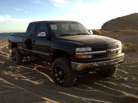

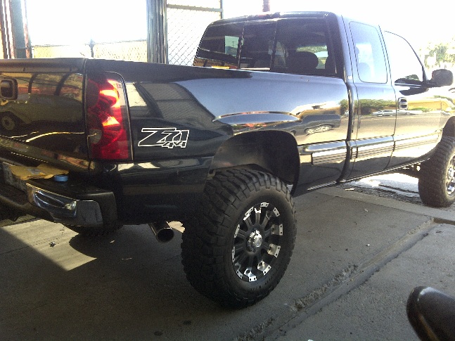

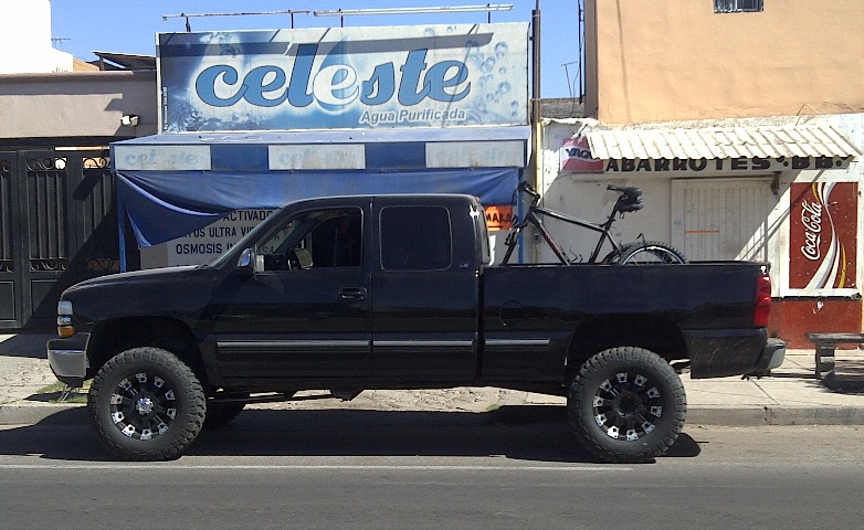

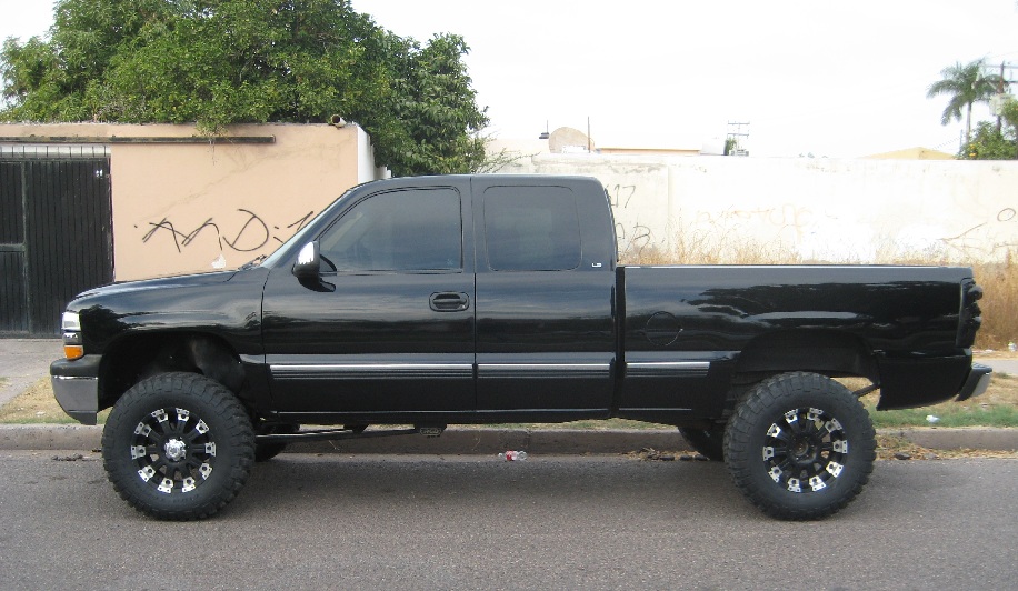

thanks i love driving my truck... here are some pics tell me what you think about it... i'll try to do something about that video of the exhaust i'll post it this week...
Beautiful truck!!! Now we just need to hear that beast!
