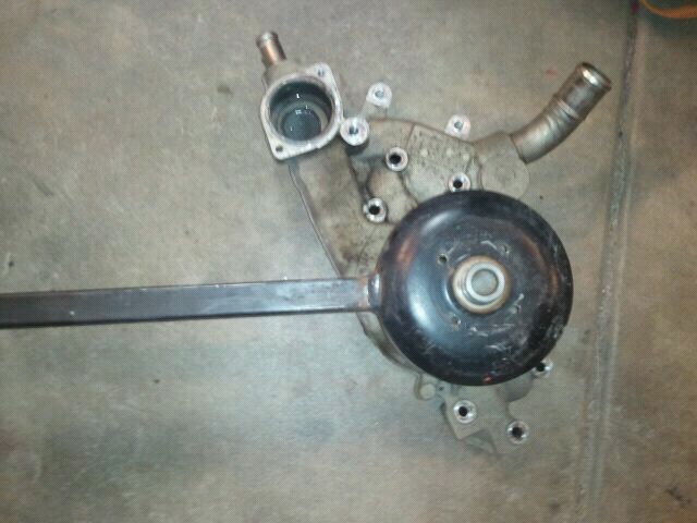

As far as actually changing it, it is very straight forward but removing the fan clutch is a bitch, and that tool at O rileys sucks and is generally worn beyond its useable state. I actually weld a piece of metal to the pulley then use a good crescent wrench to remove the clutch it works everytime but if you dont have a welder that idea is useless :eek: , I always use some non hardening sealant on the water pump bolts just in case.
