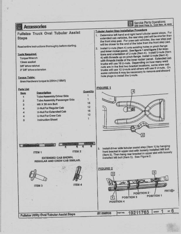

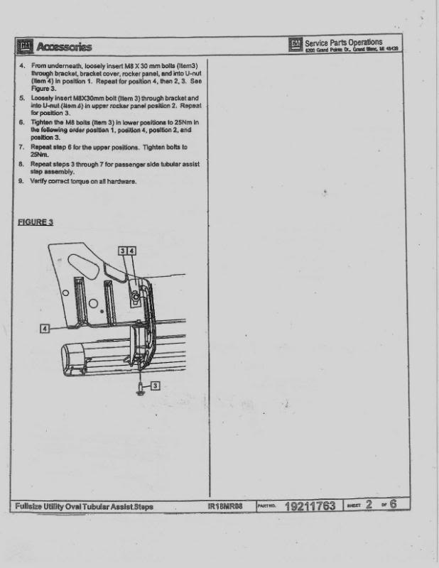

I just picked up a used set of GM step rails for my '09 CC this evening and would sure like to see the installation instructions. I realize they go in pretty easy, but the body bolts and U nuts are missing and the instructions would help clear up what I need to purchase. I did see another post on this site that has the GM part numbers for the clips and bolts, but many dealers do not stock items that commonly available. If anyone has a link or pdf file for the instructions it would sure be appreciated. Thanks!
if no one posts it later today i can scan my instructions and email them to you. either post your email or PM me.
