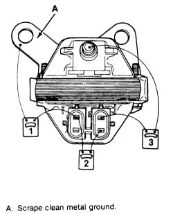

ACDELCO Coil Test (new Jan 27/10)
Coil test points from Autozone illustration (see attachment below).
Coil installed during test – test procedure from Haynes and Autozone as in illustration below – results:
  • Test #1 – meter @ high scale – spec should be infinity – got no reading (no circuit?)
  • Test #2 – meter @ low scale – spec should be low or 0 ohms – got 0.7 ohms
  • Test #3 – meter @ high scale – spec should be no infinity – got infinity

Coil test comments /questions
Both coils seem to have failed test #1 after trying with good grounds both at the coil mount and a good engine ground, and the ACDELCO coil failed test #3.
  • Is the ACDELCO coil no good, and if so why would it fail after only two years?
  • Both coils failed test #1, so is the Standard Blue Streak also faulty, or is there an error in the test procedure from Haynes and Autozone?

Found it ... thanks. There seem to be no issues with the wires, so now I have to figure out how to test it as there's nothing in the Haynes nor Autozone. Are you signed up with Alldata, and if so, is it worth the cost and can Canadians subscribe?
