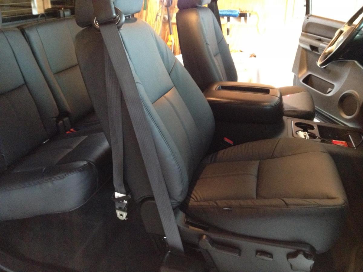

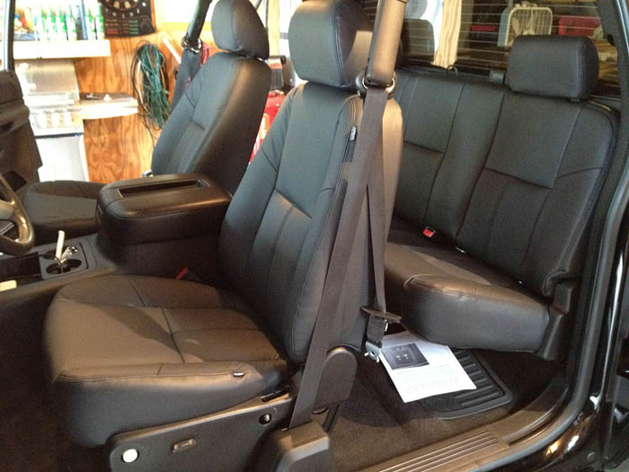

Photos of Katskin and GM heated seat install. I`ve had the parts sitting around for almost three months and finally was able to get everything together. A shout out for member PIP for his write up of heater kit install. It made it way easier than just the included instructions. I purchased the Katskins from Seats R Us on Ebay, they included a step by step DVD which was a big help and bought the heater kit from member SuperchargedSS. It took me about 12 hours to do everything. If I did not have a bad back and need to take frequent breaks It could be done in under 8 hours easy. Tomorrow it goes to the dealer to get programmed.
