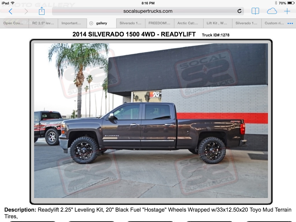

Not into lifts & such (I usually keep with stock) but this is by far the best look as have seen myself, might have to copy this look

I think this setup looks great, exact tire size you are looking at. Believe the rims are +18 offset. Pretty sure I will copy this, but with 275/70 18s. Like the looks of the 12.5 wide tire but narrower is better for my needs.
i think that looks nice!
