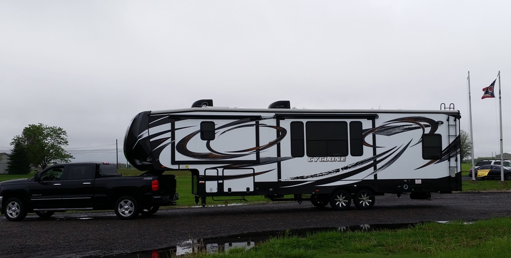

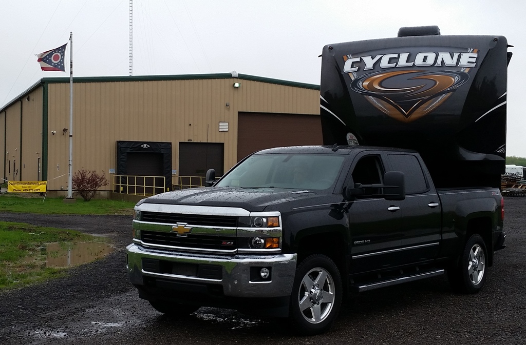

Picked up the new Cyclone Fifth Wheel toyhauler this week and finally able to check for vibration with a different and much heavier trailer load. I should also mention that I recently added AirLift 5000 airbags on the rear springs of the 2500.
After pulling this 15k# trailer from KY to OH and then back to TN in a variety of conditions, there is -no- sign of the earlier vibration problems! The airbags were only carrying 30lbs and may have helped some, but I mostly expect the vibration disappears with a heavy load. So the vibration, in my case, was apparent only when pulling a lighter trailer.
Amyway I am happy to get this resolved for most of my towing !
