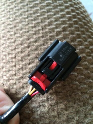

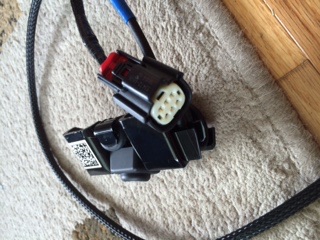

I have attached a photo of the camera but the issue we are having is how to unplug the tailgate camera? We have slid the red tab back, but still tight and don't want to break something.
Will post a photo of bracket and setup when we get the tailgate camera removed.

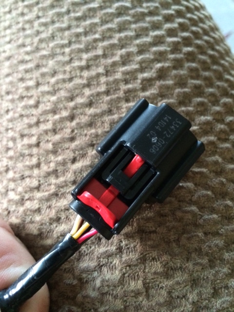

I figured out how to unplug the camera. Pull the red tab back and squeeze the black part in front of it (pivots), then I pulled straight out.

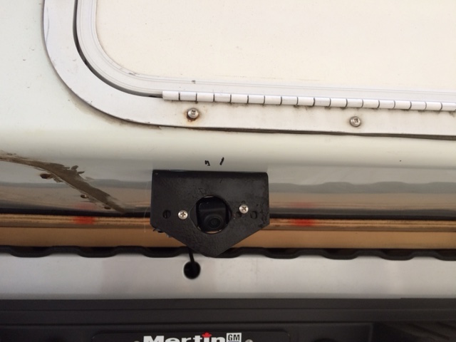

I got a bracket from a truck outfitter shop and had to slightly modify to fit the camera, but it is now installed on our Bigfoot camper.
Here is a photo of the camera plug, noting the red tab and the black 'pivot' in front of it. I also attached the camera install, using the 8" factory screen
