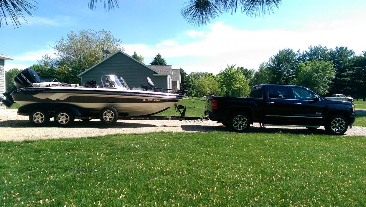

Looking at doing a RC 2.5" level and getting tires. I would like to maintain some rake so should i get a 3" block for the rear? Does that require longer shocks then?
Can I get a 295/55 trail grappler to fit with no rub? I am keeping stock wheels because I really like em.
Also the boat might sag the back end a bit and that looks extremely stupid is anyone running airbags yet?
Thanks for any help in advance for this new member.
I searched this board for two days and it answered some questions but not all. Pic of truck and boat is below.

I have the 2.5" RC Level on the way and for the time being just doing the 2" block. If I don't like it I will get the 3" and some new shocks for the rear.
Going with 275/65R20 goodyear duratracs mostly because they were a bit cheaper than nitto and toyo and people seem to really like them.
I have the 2.5" installed with the 2" block. I really like the look right now. I wonder what kind of sag i'll get towing my boat. Might have to get some air bags to keep that from happening.
Here is a cell phone pic in the rain.
