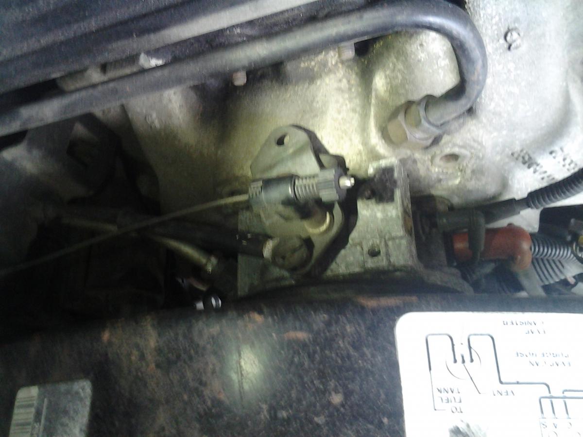

Im told by a family member that the idle is adjusted via a stop on the cable. It looks like a brake cable for a peddle bike that runs next to the throttle body and air filter drivers side. This has a lot of play in it though and hanging the screw didnt seem to affect it.
Is this for the idle or only for the cruise control?
Edit: for some reaaon the pic is upside down
