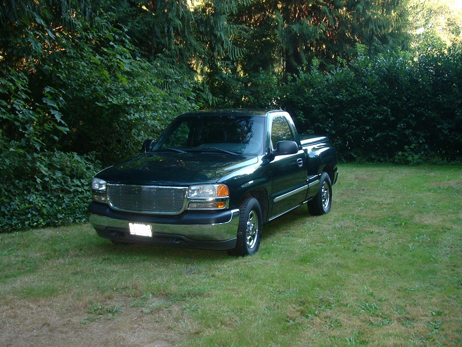

I have a 2001 GMC stepside with 4.3l auto that I bought 2 years ago. Love the truck,25mpg on my trips, you can't beat that.
