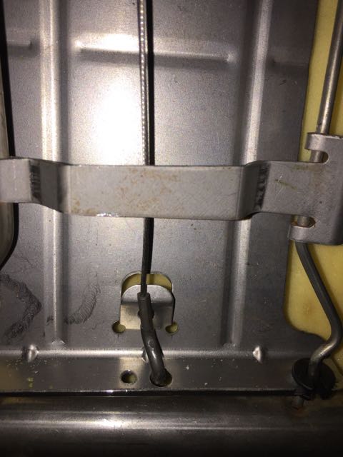

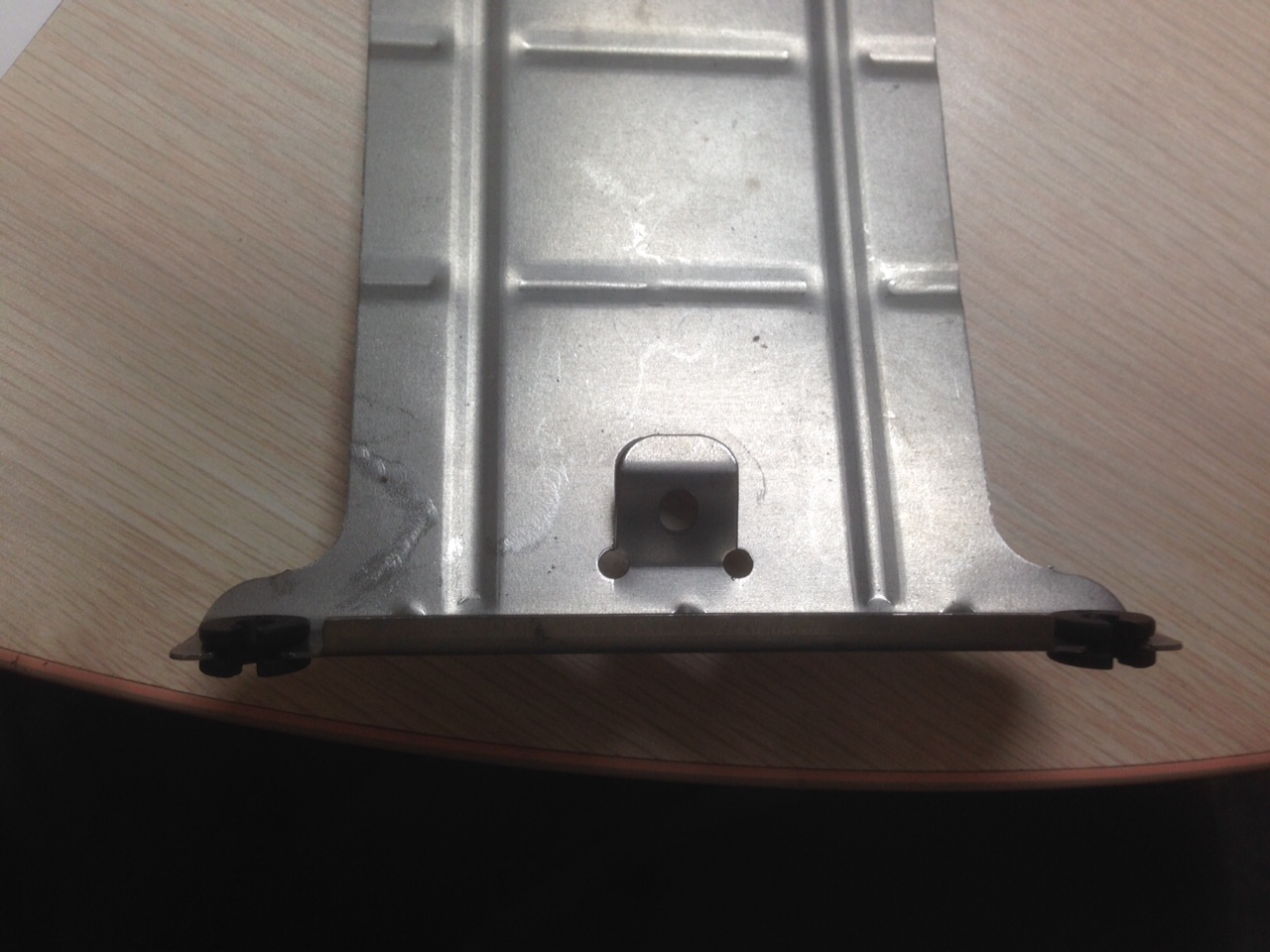

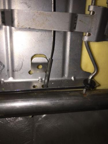

I neglected to update this previously; here are some photos. For reasons unknown, I never took a full picture of the new part which is a Schukra ("internal") part # 5023003A. This fits the 1999 Silverado new style and whatever variants use the same system.
Photos of the black plastic one are my old broken part showing where it broke. The new part is metal and two of those three are of it installed in the seat back.
Installation, once the seat was opened up (foam lifted and back accessible) took about a minute. It's a really nice design, actually. Support from Schukra was nothing short of superb.
