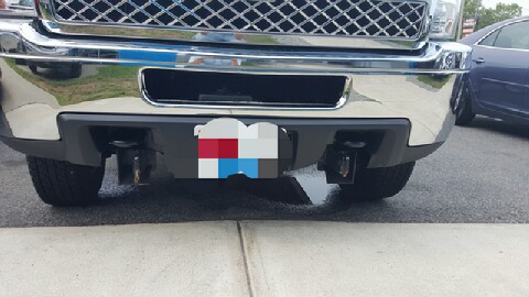

Called and said that there is no coolant leaking. No lie there was a gallon of coolant under my truck. When I walked into the service the lady marched to me and says you can't get your keys until you pay. I tell her I'm not paying, she laughed and went and got the manager. I take him out to my truck and show him and then show him the slip that says no coolant leaking. He said they will fix it first thing in the morning. Maybe I do need to tell them how to do their job rob

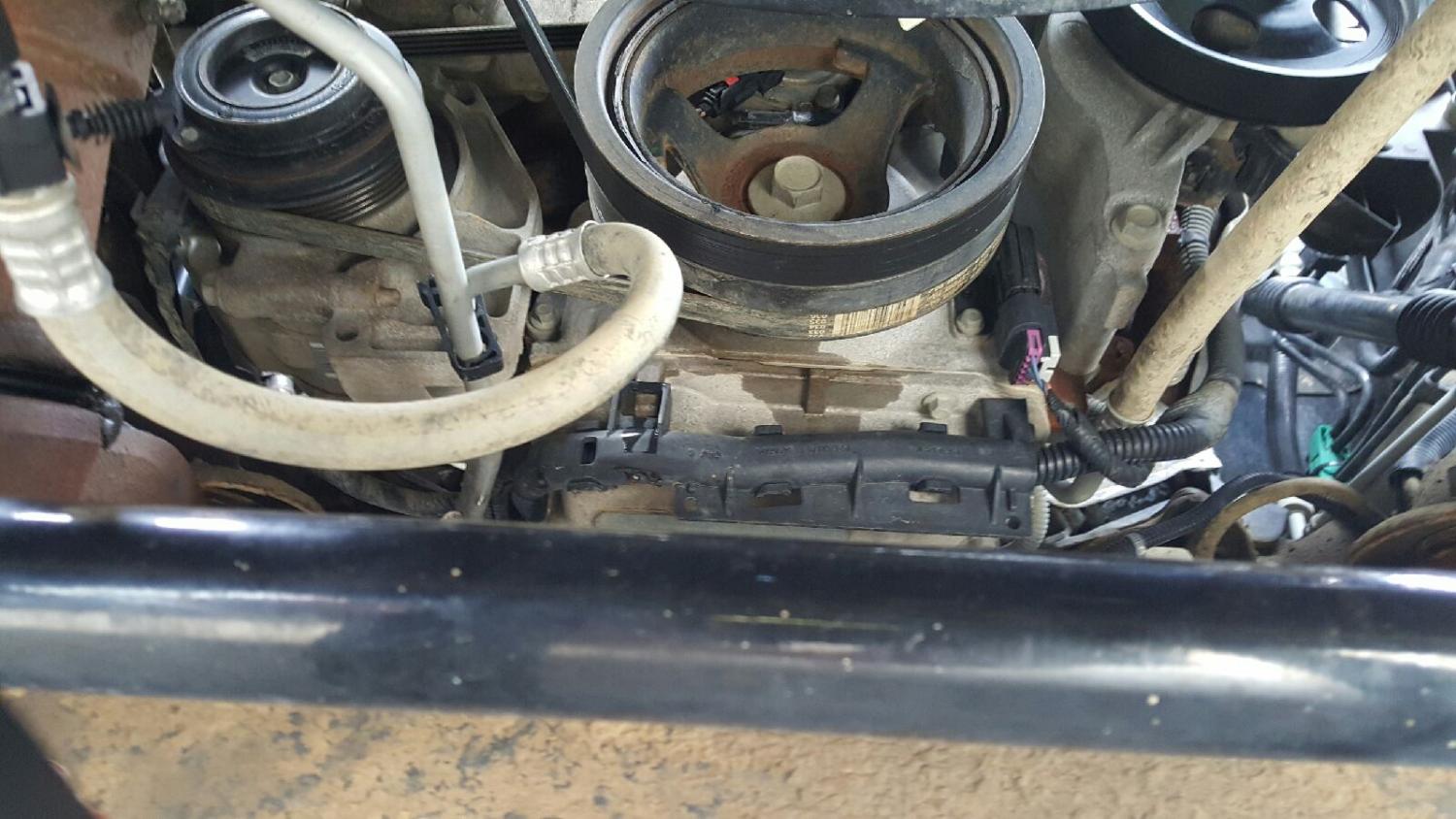

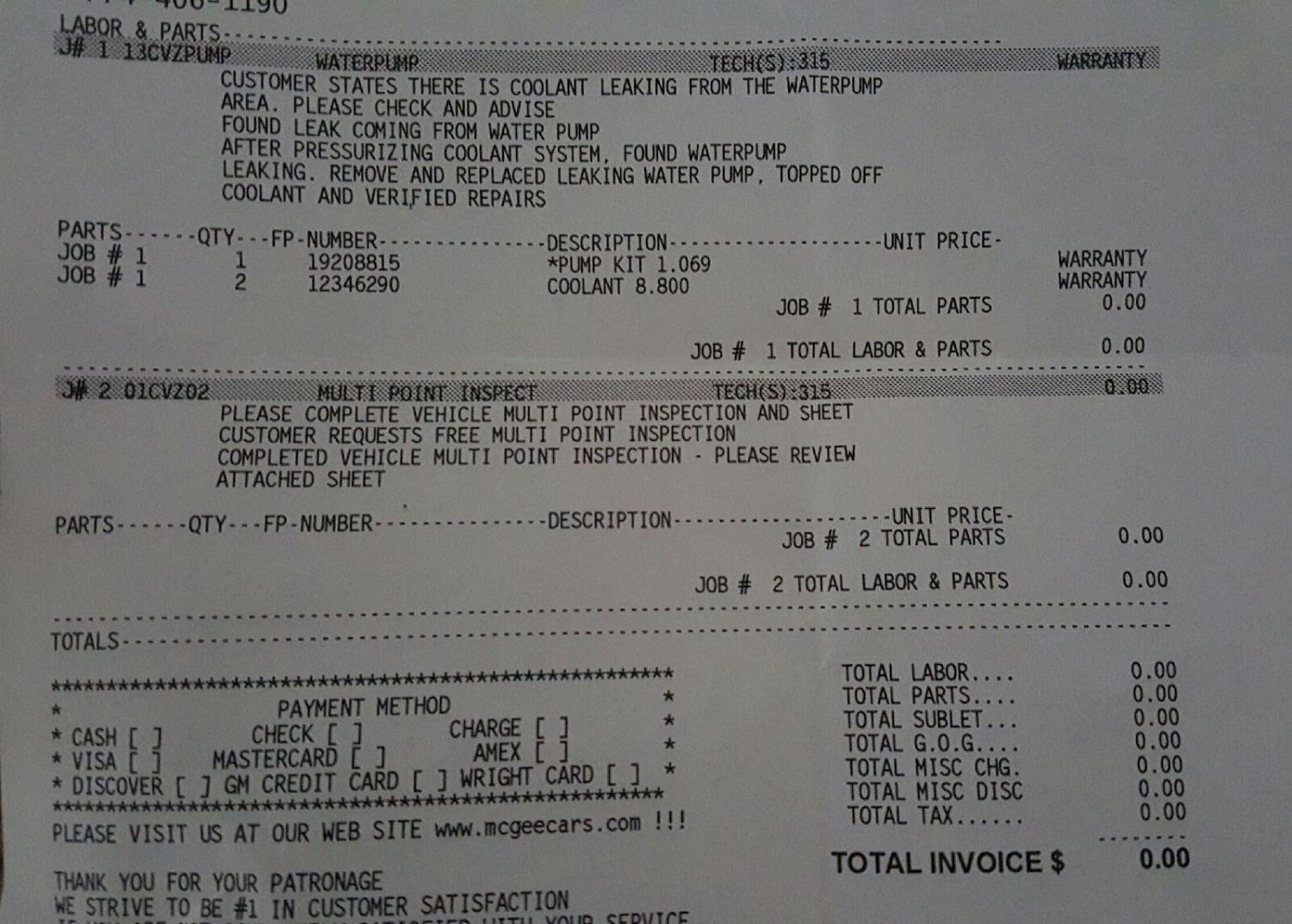

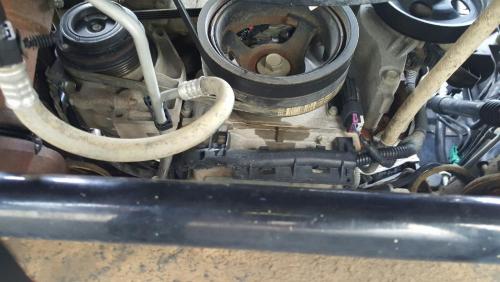

Yup, after 3 hours of "research" they discovered it was leaking from where I said. The weep hole. I have a few pictures but they are to large to up load.
Showed up to get the truck and they had a bill for $890. After talking to the general manager I got it all covered by warranty.

Sorry it wouldn't let me upload them at once. The 2 pictures of the truck are when the dealer couldn't find the leak. That's how the truck was sitting when I went to pick it up "with no problems" all the on the ground is coolant.
