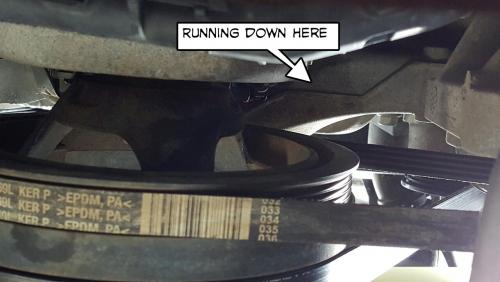

I seem to have coolant leaking from the water pump . Truck has 20k on it. Called local dealer and they can't look at it for a week. Anyone hear of this before?
I just went under the truck with a mirror and it seems to be from behind the pump or the back of the pump. Maybe a sensor. I sprayed it with some soap and water. I'll try to get a better look at where it's coming from.

Yea, still have factory warranty. Truck was made 03/13 and has 20k. So I should have no issues. After looking at it more it seems to be coming from the seal behind the pulley

I dropped it off at 8,told the lady at the service desk the truck is leaving a puddle of coolant over night. It seems to leak faster as it cools. She said no problem, they will look at it and find any issue.
815 I get a phone call, I'm still in the parking lot waiting for my ride to get me. It's the lady saying that there is no leak and my truck is all set. Also wanted to know how I would be paying the $105 diagnostic fee. I asked if I could speak with the tech which is apparently against policy. Not really sure what tests could have been performed in 15min. Not to mention it seems to just leak when it's cold. (the engine)
After several minutes of explaining that to her she sighed and said I guess they can look into it further.
Your charging a hour shop time, at least wait a hour to call.
If it leaks hot it must evaporate to fast to see. When it sits for a few hours there is a puddle under the truck. My thoughts are the weep hole or a gasket. I've added 10oz of fluid over the past few weeks to keep it topped off.
