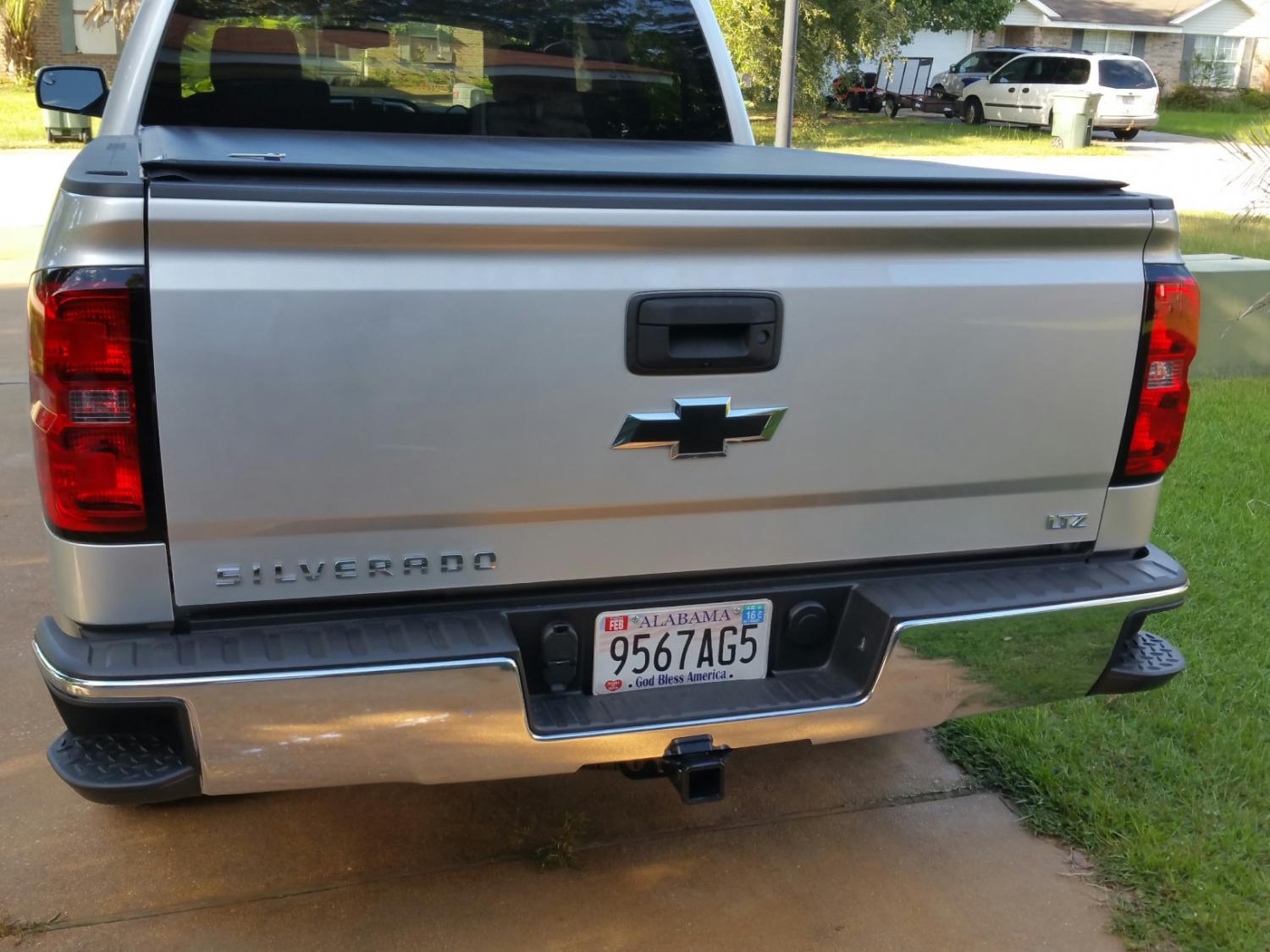

Does anyone have any pics of black bowties (oem, painted, or plasti-dipped) on a silver ice metallic? Im considering it, as everything on my truck is either silver, black, or chrome. The gold just sticks out like a sore thumb. Thanks in advance!
I have a silver ice metallic and have the bow tie plastidipped I might have a picture in the gallery but I can get a better one in the morning for you if you would like
Sent from my SM-G925V using Tapatalk
Please do! Thanks
I also Plasti Dipped my bowtie black. Been over a year, still looks good.
Ok yea, im convinced. Guess ill be going to the home depot today!
love it!
Thanks! Im kinda considering doing my bowties on my wheels, but it seems like alot of prep just for those little ones. Maybe if i get bored...

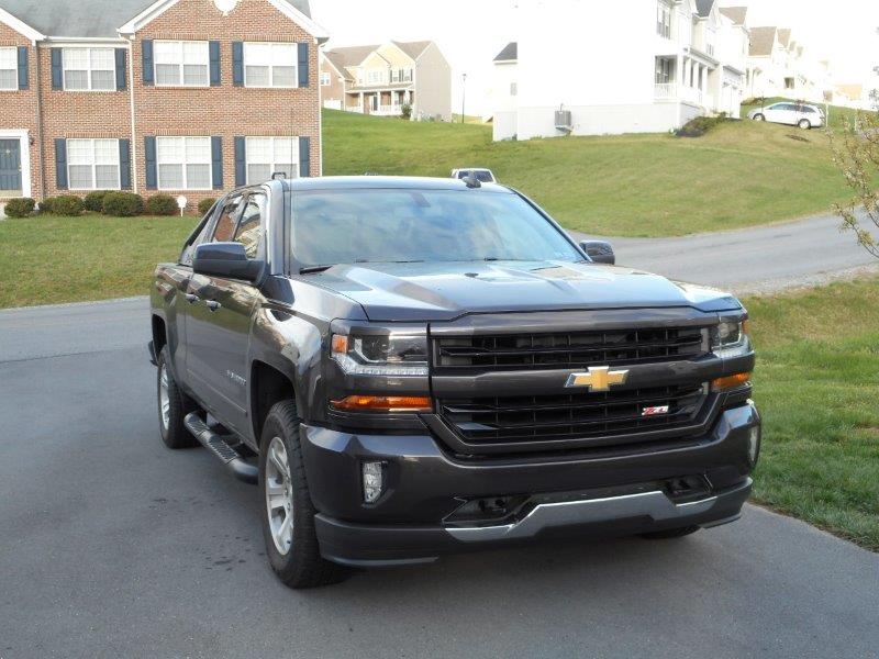

Here is mine, but its the Iridescent Pearl color and black vinyl over the emblem.
