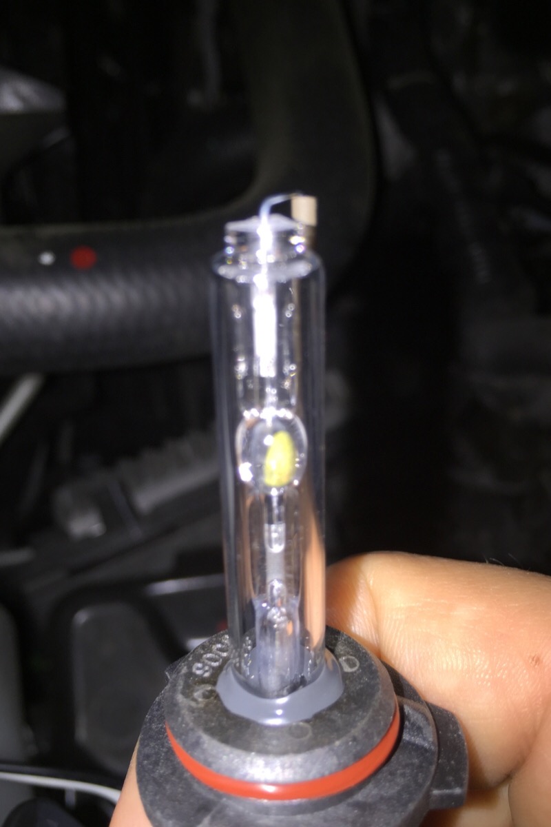

So I just put a Xenondepot HID extreme kit in my Sierra over the weekend. Bulbs have maybe an hour or so of run time on them and tonight I pulled one bulb out to try and rotate to a different position just to see if made a difference on the output and when I did I noticed a large yellow spot in the bulb. Looks kind of like powder residue like the remains of something burning. Is this normal for HID bulbs to do this or should I be requesting some new bulbs from Xenondepot? I've already sent them an email with a picture but thought I would ask on here as well. Thanks for any help! Here's a picture:
two reasons for yellow spot are cycling the hid bulb off and on too many times or the ballast voltage is low and hid bulb is having a hard time igniting
Thanks for the response...by cycling them off/on too many times what kind of time should they remain on before being turned off again once ignited because they get cycled a couple of time in the morning like when I unlock my truck they come on but usually turn off before I get in and start the truck up. Also I keep the lights in auto position so they may come on and go off a couple of times on the way to work depending on if I'm facing the sun or not.
