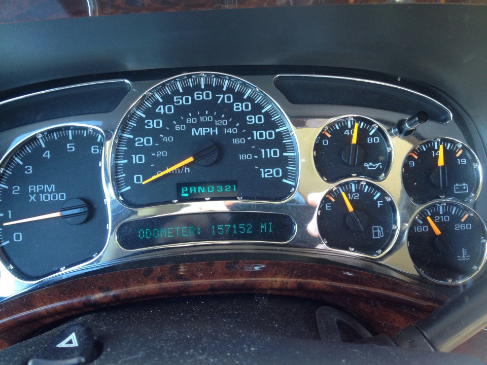

I tried motor flushes and a mechanic suggested adding 10w40 oil and lucas treatment and it was gone for a week sweet I though it was gone then it returned so I had the shop I bought my used sebring from replace the lifters. and new synthetic blend 5w30 oil and it was quiet for a day. back the next. I read online a guy replaces the o ring on the oil pick up and it was gone also people replacing the oil pump wich made sence as it came when idling idling I ws 25 psi about 25 driving around town. so I had my shop install a melling 10296 high volume pump
http://www.autozone.com/internal-engine/oil-pump-performance/melling-oil-pump-performance/54261_276539_0/
now NO MORE TICK even starting there is no valve noise. and idling the psi is about 50. driving 1500 rpm about 60 and stay there
