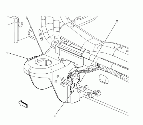

Check the 60A abs fuse in the underhood fuse box. On a functioning vehicle, you should have continuity from the disconnected batt cable to the abs module conn 1 terminal B red wire. Not how I would test it though. Just test for voltage at that terminal. Also check the ground on the frame. Front left body mount area .
