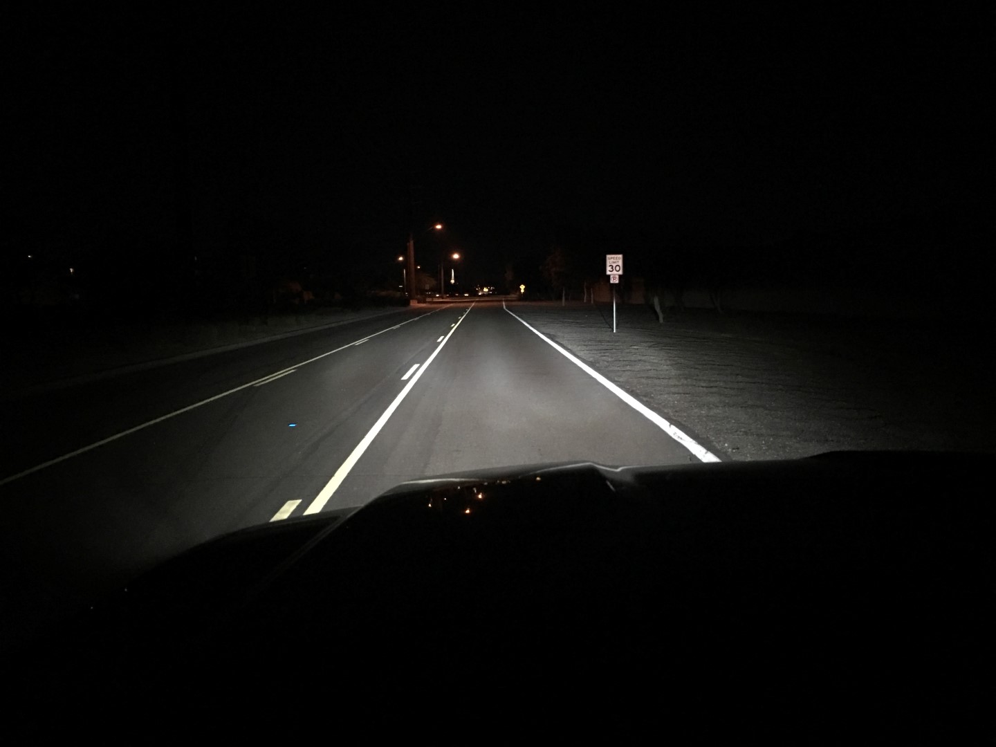

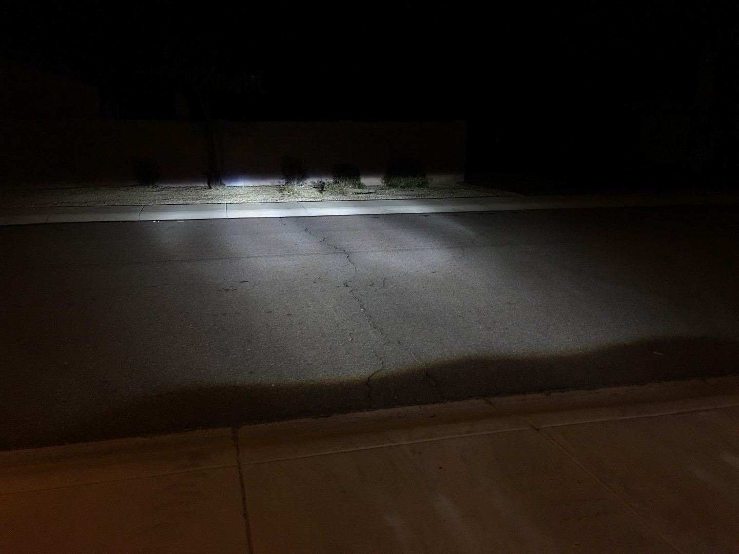

Hi all, I just installed a 9012 Xtreme HID kit from xenondepot.com but I'm not digging the light pattern on the road. Is this normal because it bugs me to see this pattern directly in front of me all the time. The bulbs are seated properly I have checked. I don't see anything on the projector lens either.
2014 GMC Sierra SLE
2014 GMC Sierra SLE
My guess, the use of halogen projectors with a hid kit. You're going to get this effect until you retrofit and replace your projectors.
