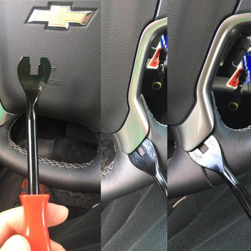

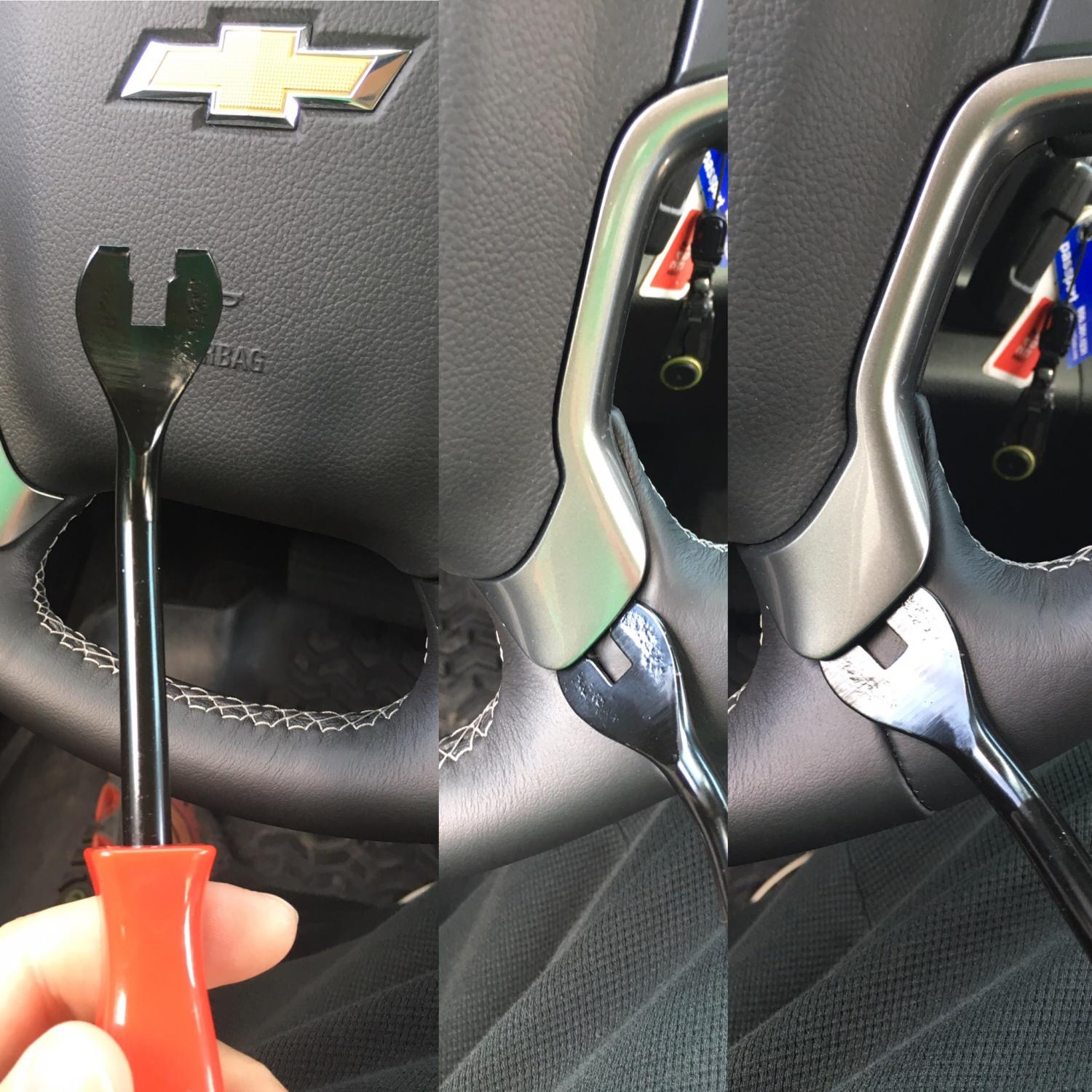

Paulybee - I am about to attempt removing the steering wheel trim to wrap it. Did you disconnect battery and remove screws on back side of steering wheel, or did you just grit your teeth and start prying?
