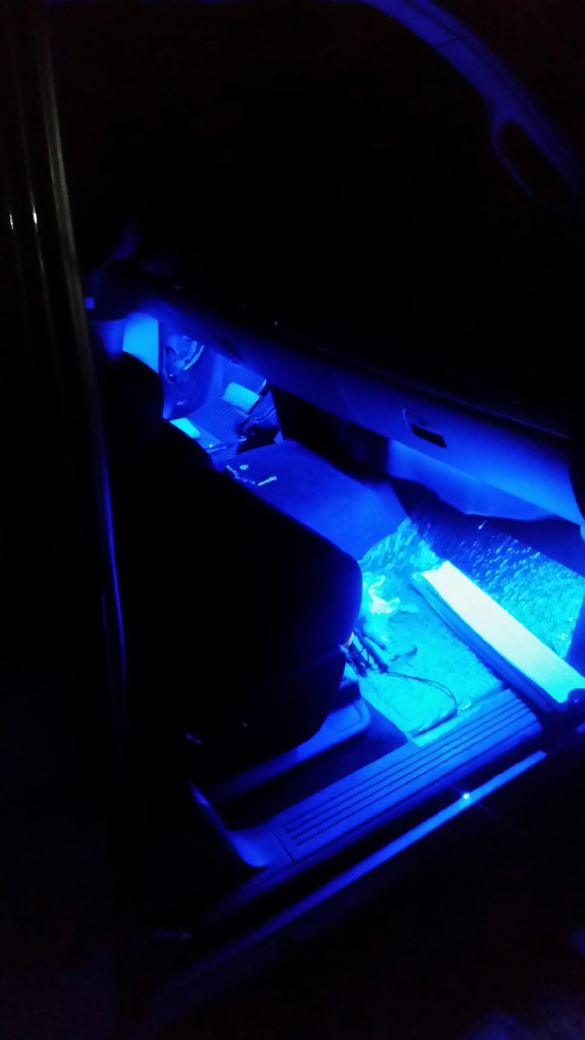

I was helping my buddy install some interior LED lights in his 2013 silverado ls last night. I mounted the on/off switch next to the headight control knob left of the steering column. When I was putting the dash back together I noticed 2 wiring harnesses where the trim panel for the headlight control and drivers side air vent connect but only one connection on the removed panel. One is a larger connector that connects to the headlight control and the other is smaller that I couldn't find where it would connect. Can anyone tell me what that smaller harness is for?
I'm pretty sure it's for an accessory that his truck doesn't have. It's a very base model '13 Silverado LS V6 RWD EXT Cab. Damn truck doesn't even have a CD player, we will be taking care of that soon. He's drove all day today and hasn't noticed any issues.
Driver Information Center, it's a set of buttons that can be added on with a new a/c vent panel. Shows you avg mpg, trans temp, tpms info, oil life %, and few others as well as control over some vehicle functions
Ok, he has LED interior lights now knock his socks off and install the very reasonably priced (IMO) DIC panel modification. :driving:
He would never look at it. I'm sure of that. When his last fuel pump went out out I told him not to let his tank get below 1/4. I still have to fetch him gas every few months when he runs out on the side of the road.
