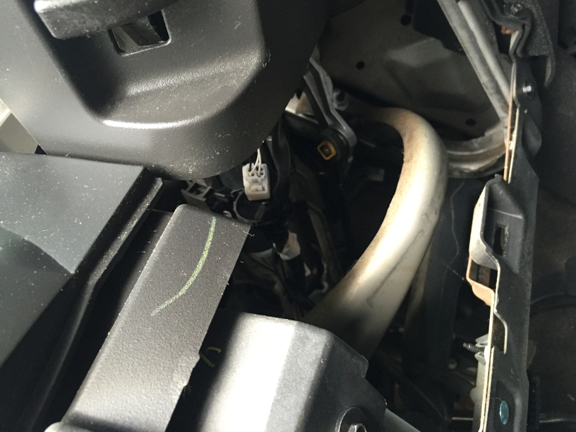

hello,
does anybody have the pinout info for the connector seen in the picture?
im trying to troubleshoot my tow/haul button
there are 2 black and 2 white wires.
thanks!
i found a wiring diagram.
in case anybody is wondering in the future if you short the 2 white ones then tow haul should come on.
this is the case with my truck, looks like I need a new shift lever
