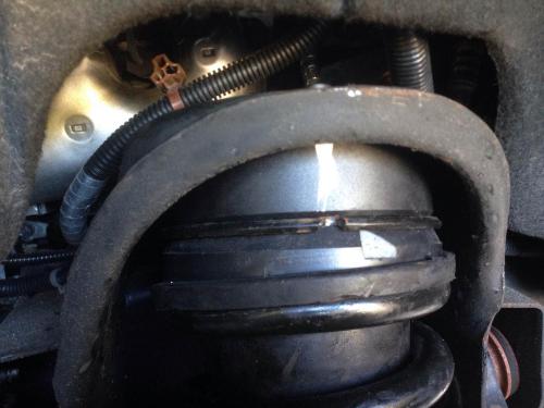

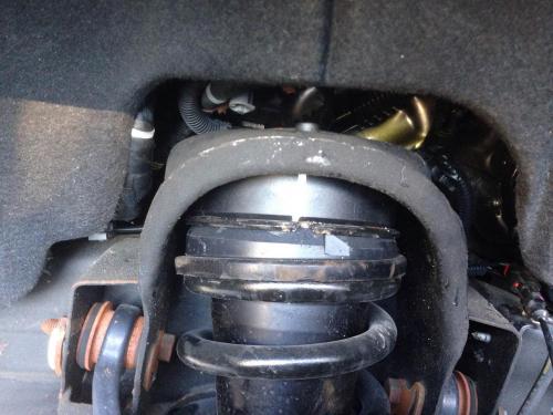

Just installed motofab 3"F & 1"R leveling kit. Does this l
So the trucks sits considerably higher and now I can see stuff I couldnt see before lol. Can someone tell me if all of this looks normal? Sorry, I'm a truck noob.
PS I have no idea what the white stuff is.
Did you mark the spacer? I have that same exact level ...3" by motofab. I don't have anything on there
Sent from my Nexus 6P using Tapatalk
I did not, but the installer may have. How do you like yours? So far I can't tell any difference in ride quality. I heard from reviews that it makes things stiffer, but I strongly disagree. So far impressed, but just wanted to make sure it was a normal looking install.
Mine rides just like stock. Have about 7k on the level know. Drove from MA to FL and back..about 3000 miles. Not one problem. Just by looks i would think that's mine. I added a 3 inch block to the rear as the 2 inch block made the truck look nose high. 3 in front 3 in the rear ..i love mine
