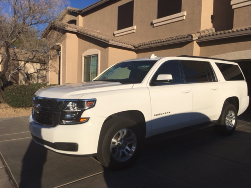

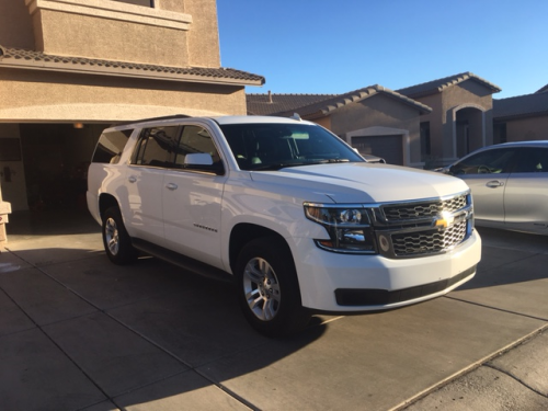

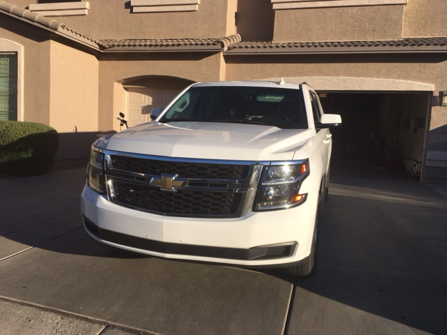

We just finshed putting on GM Part # 23365760
It is the Lower Deflector that comes on Tahoe PPV. it is about 1/4 of the length of the stock piece.
It's a small mod but I believe it has changed the look on our suburban quite a lot, we like it.
The main reason was to gain ground clearance, for these off-road times, like when parking at a mall to clear curbs :)
Also already helps on steep driveways and coming out of parking lots...
The removal of the old piece and installation of the new one was quite simple. Remove some bolts/ torque screws, pushing down some clip, partial removal of front wheels liners.
I can't comment on any decrease in MPG on highway, as we use this truck in town.
