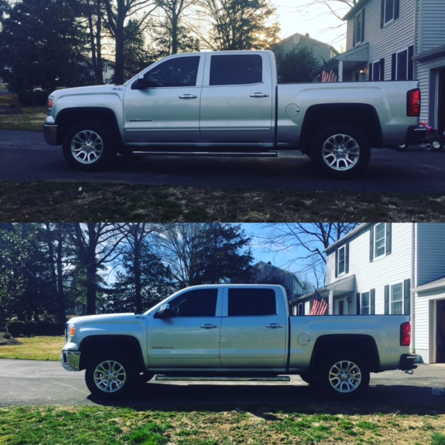

I have a '14 GMC sierra 1500 and just installed a 2.5" RC level kit. When I took it to a local tire shop to have the allignment done they informed me that both upper and lower ball joints were bad and needed to be replaced in order to allign wheels. I only have 32k on the truck and the next day when I took the truck to the dealer they replaced the lower ball joints under warranty with that being the last day of my warranty. Re-installed kit and took back to local tire shop......still no good because of upper ball joints. Still going back and forth with dealer over further repair. Just don't want to have to take this kit off a 3rd time!
forgot to mention.....I only had the level kit on for 2 days and drove maybe 10 miles...Damage to ball joints were under stock setup
