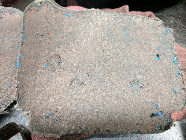

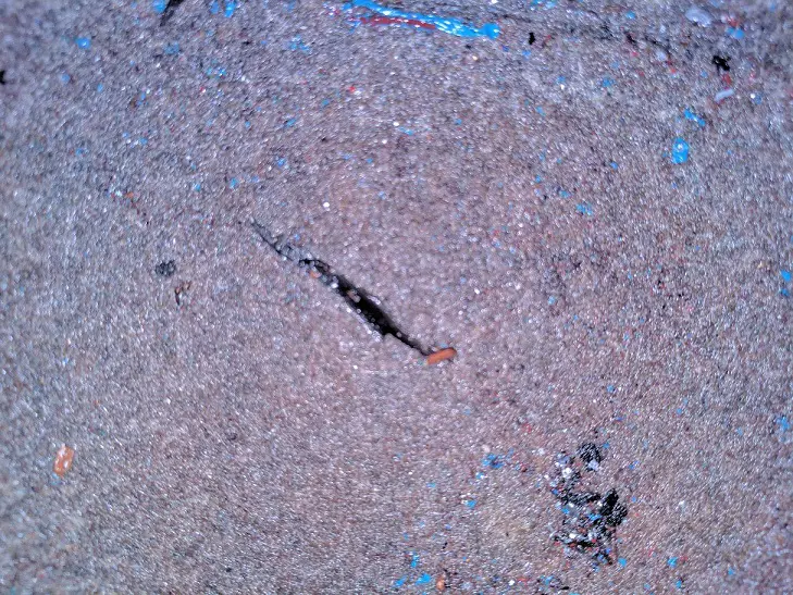

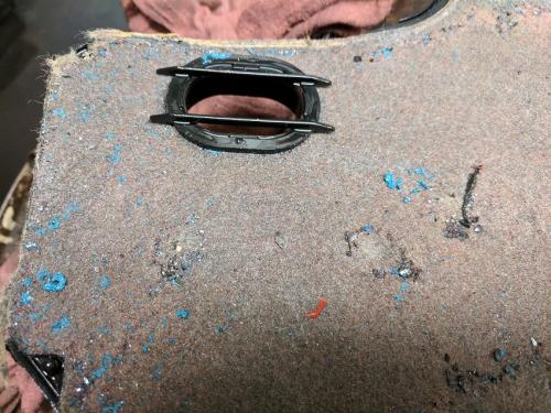

Pan has shavings in it. We pull the filter and its got tiny little metal parts and what looks like blue paint chips.
I was a bit baffled at the time so didnt think to take pics of the pan. I have included pics of the filter.

It looks like you cut the filter open? The blue stuff looks almost like the paint-like coating that is on the servo cover O-ring. How that much would get rubbed off and sucked up into the filter is beyond me. Just a guess though. Is any of it in the pan? Anyway, if it were that, it would imply that the servo cover is improperly installed, which will allow it to NOT shift into OD, as the cover acts as a stopper for the 4th piston to push again to engage the band. Are there any leaks from the transmission or loss of fluid?
As far as the shavings go, good luck. It sounds like damage has been done. Keep us updated!
Yes we cut the filter open. I have 0 oil in my driveway and I've idled lots of places with the heat on. And I have an OCD habbit of looking under the truck for puddles. Never seen a leak.
Are you talking the servo on the side of the trans? If I got a pic could you tell?
There is the same color blue on one section of the pan gasket on the outer rim of the gasket....
Yes, the round cover on the side is correct. You mention the blue on the gasket....that sounds like someone goobered some blue RTV on the pan gasket to stop a leak, or if the pan edge was warped, to get it to seal properly. That's likely what got sucked up into the filter, but almost certainly not a cause of failure, short of it completely clogging the filter media and starving it of fluid. The few flecks of it wouldn't have had any effect, hence their capture in the filter.
