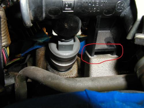

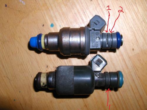

Had all the rear fuel lines connected and both front and back bolts that hold down the plastic fuel rail.The new injector as seen in pic 1 has 2 grooves on rail end (1 & 2).When I connected the metal clip to groove 1,the injectors did not look to be fully seated on the spray end.The plastic rail is pretty much fixed in place.Pic 2 shows rear rail bolt underside bracket resting on lower intake.So where the rail sits,it stays,no play up and down to be able to push injectors deeper on spray end

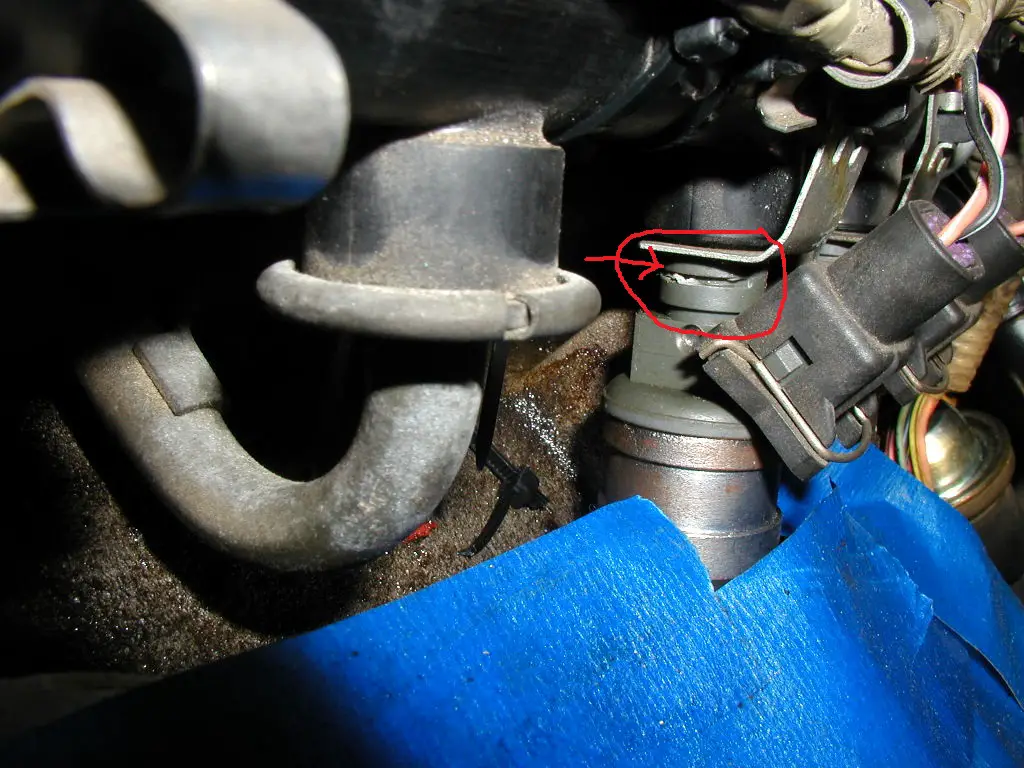

I removed all the metal clips (no fun) and placed them on groove 2 and they seem to be seated correctly on the spray end as they pushed down a bit
Anyone ever run into this issue.?
Will they work with the clips on groove 2? pic 3
The older injectors only had one groove as seen in pic 1.The replacements have 2 grooves as seen in pic
Both the o rings on each injector ends match up (distance)
