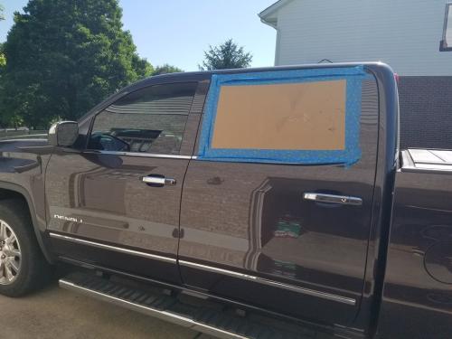

Does anyone know the part number for the rear left window regulator? The part number I found, 23274600, says that it is discontinued and does not tell me what replaces it.
Came home last night from work with the windows down only to find that I couldn't roll them up again. I can hear the switch clicking so I know it has 12v, but the click isn't as "strong" as a click as the other windows. I'm guessing it's either the motor or the regulator but since the regulator includes the motor and isn't much more I'll just do that and replace both...if I can find the part.
It's pretty irritating that it's even having a problem. Being a '15 and hardly ever using the windows there is zero reason this should be an issue. I'll be taking the door panel off today to try and at least get it up again until I can find parts. Thankfully the rain isn't supposed to come for another day otherwise I would have been really pissed.

Thank you. Yes I am out of warranty. I just started the car to go pick it up from the dealer and the window rolled up & down like normal. Wtf?

I'm at a loss now why the window would all of a sudden work again after just sitting overnight.
