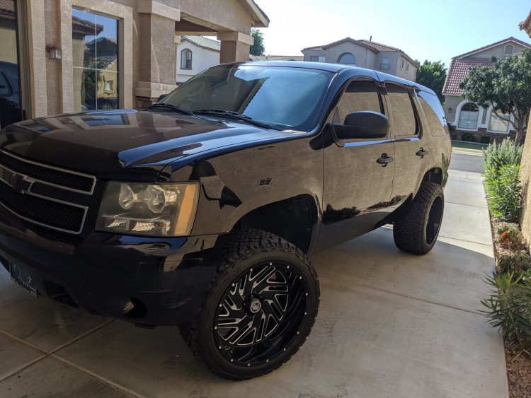

Just got picked up the truck and i love it, it looks great and seems to ride great also. I put the 5100's at the highest setting and left the top 1/4 inch spacer. It is perfectly level. I measured the gap both front and rear and they are right on. I definitely happy i went with the 275/65r20 vs the 275/60r20. Fills up the wheel well better. I will try to post a pic on more level ground my drive way slopes so the pics might look a little nose high.

I'm not certain but i used a 1 5/8" strut spacer on my Tahoe  creating a 3" lift and the angles where terrible, the diff drop kit is under 100$ and you can have it installed in a hour.. even if you don't do it yourself your still under 250$ installed
