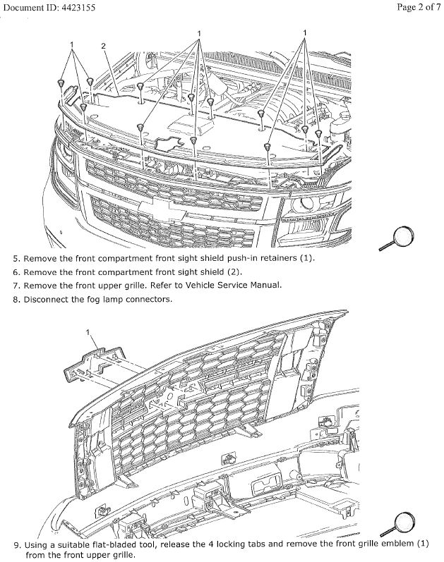

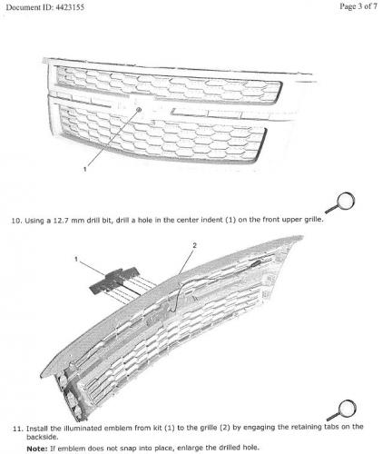

I was able to locate the documentation. It is different from the Silverado instructions. I will see if I can post them to this thread.

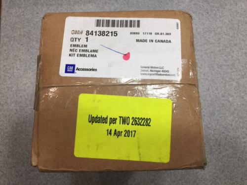

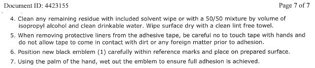

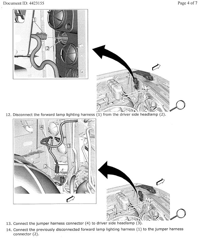

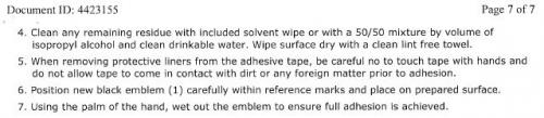

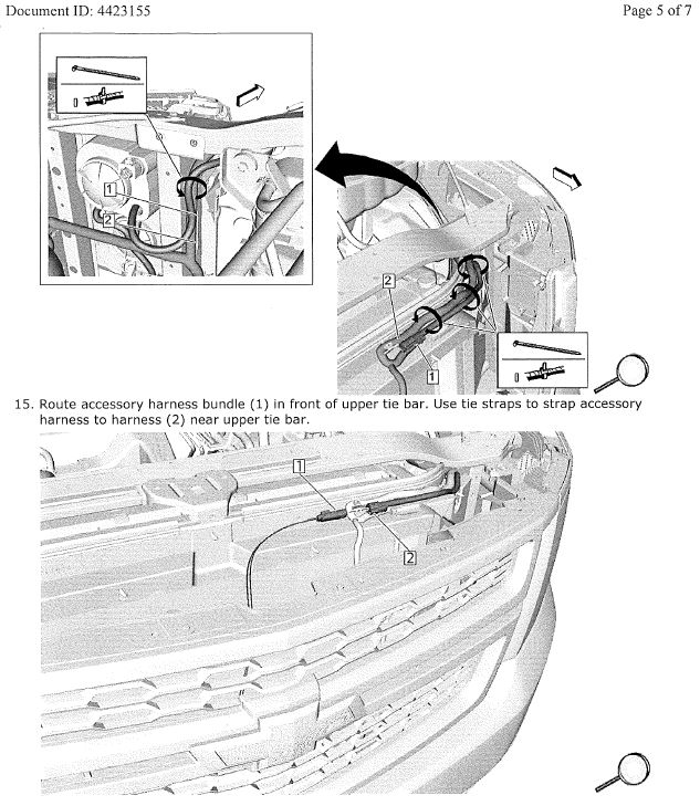

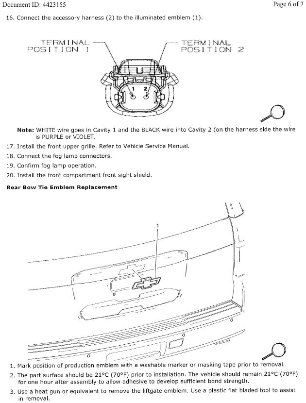

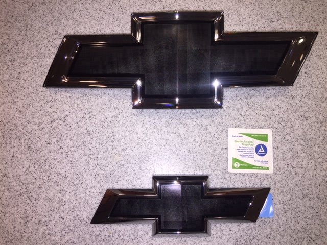

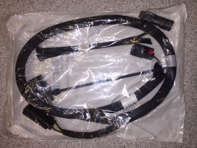

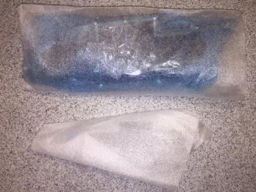

For those that are interested, here's what comes inside this kit, including the "lack of instructions" information page.
This is the black bowtie illuminated kit for a 2015-18 Tahoe/Suburban
