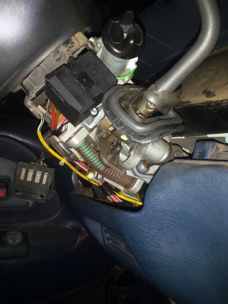

The truck has been setting for 3-4 year before I got it and it was stolen somewhere between that time. Anyway the front brakes were locked so I replace them and the rear calipers. The brake booster was also bad so it replaced it and the master cylinder. Got the brakes working and give the truck to my sister to test drive and noticed the brake light weren't working right so I replace the brake switch. She drove it home about 4 mile and the next day my niece drove it to school and back about 10 miles round trip. She was going to drive it to work and it would not shift out of park for her. I did remove the shift interlock solenoid and it only power up and works when the key is in the run position. Is the default position open or close for the solenoid? I took it apart and can see it engage when the key is in the run position only. I guess I should have tried stepping on the brake to see if the solenoid disengage but I didn't.
Okay I reinstalled the shift interlock solenoid and removed the brake light switch and manual push the switch in and it unlocked the shifter when the key is in the run position so I think everything is working. I may need to make sure the switch is mounted to the pedal correctly. But the shifter still can be shifted into gear without key in the ignition. Is the shift interlock solenoid supposed to have 12 volts 24/7 unless the brake is pressed. What keeps the shifter from shifting when the key is not in the ignition?
