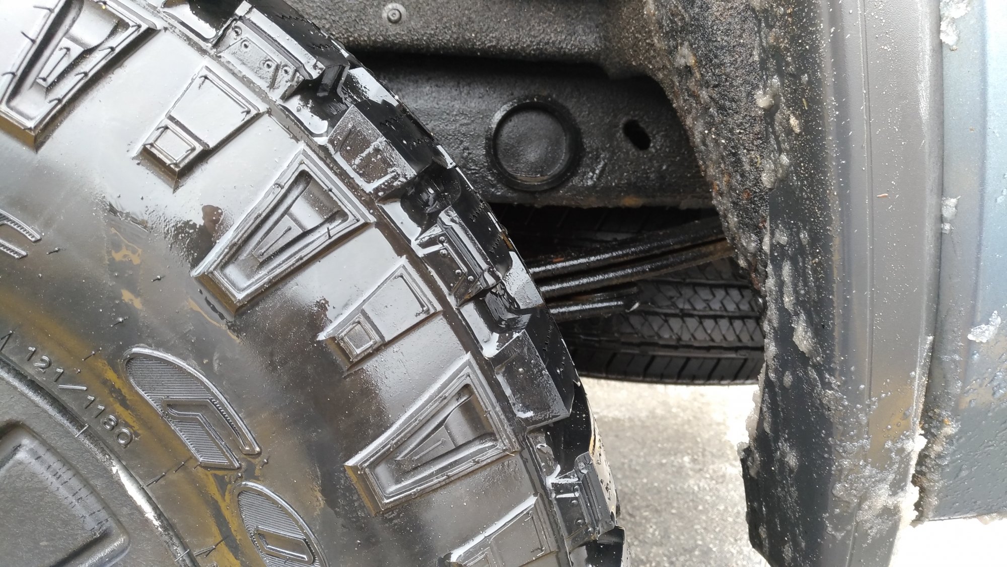

here is the rear of my leaf spring, driver side.
see how there is no gap
Did you buy your truck new?  If not, maybe the blocks were removed/altered by a previous owner
I got it bran new, first and only owner.
Stock Blocks are in there
