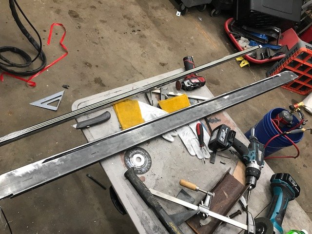

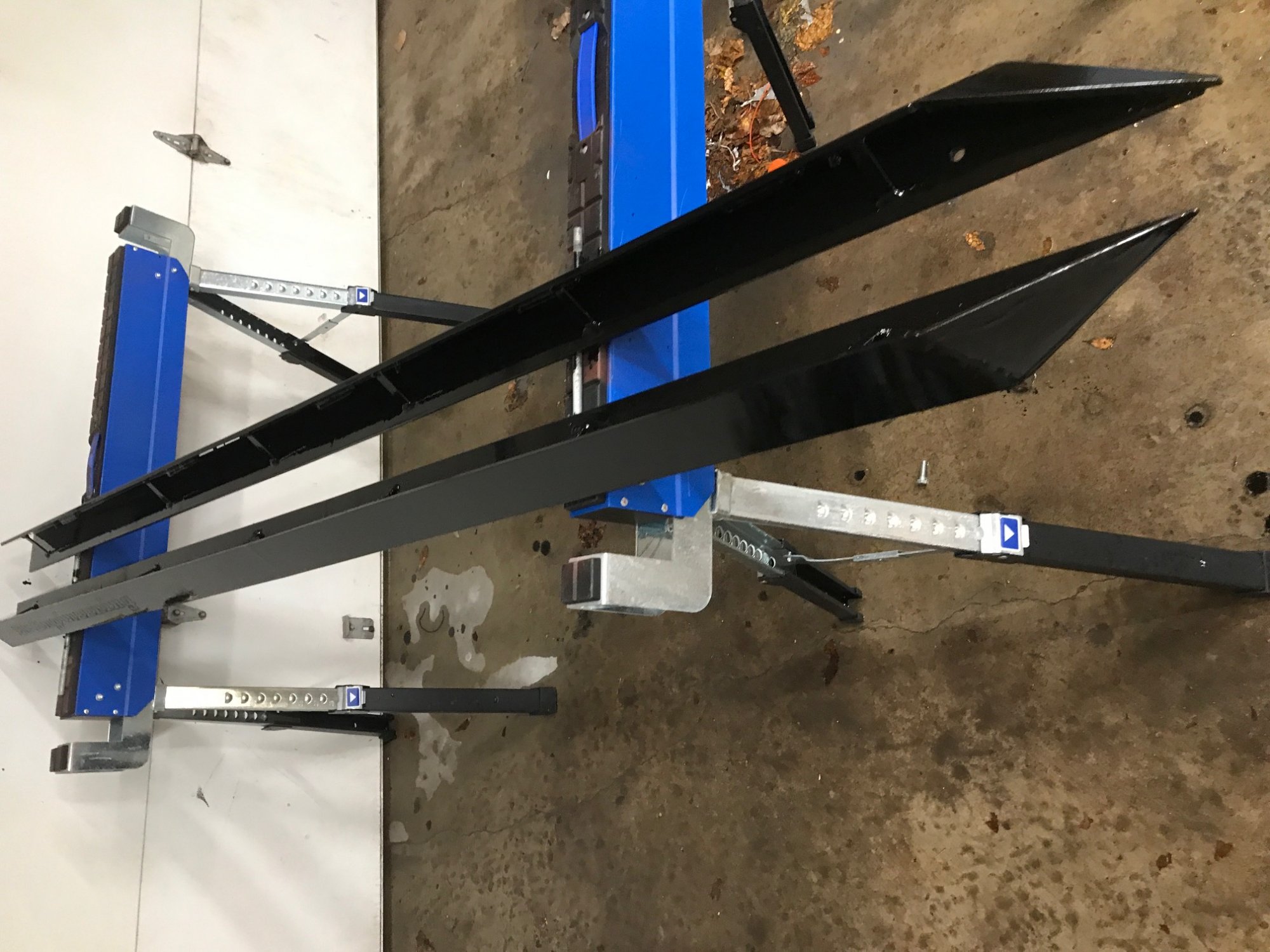

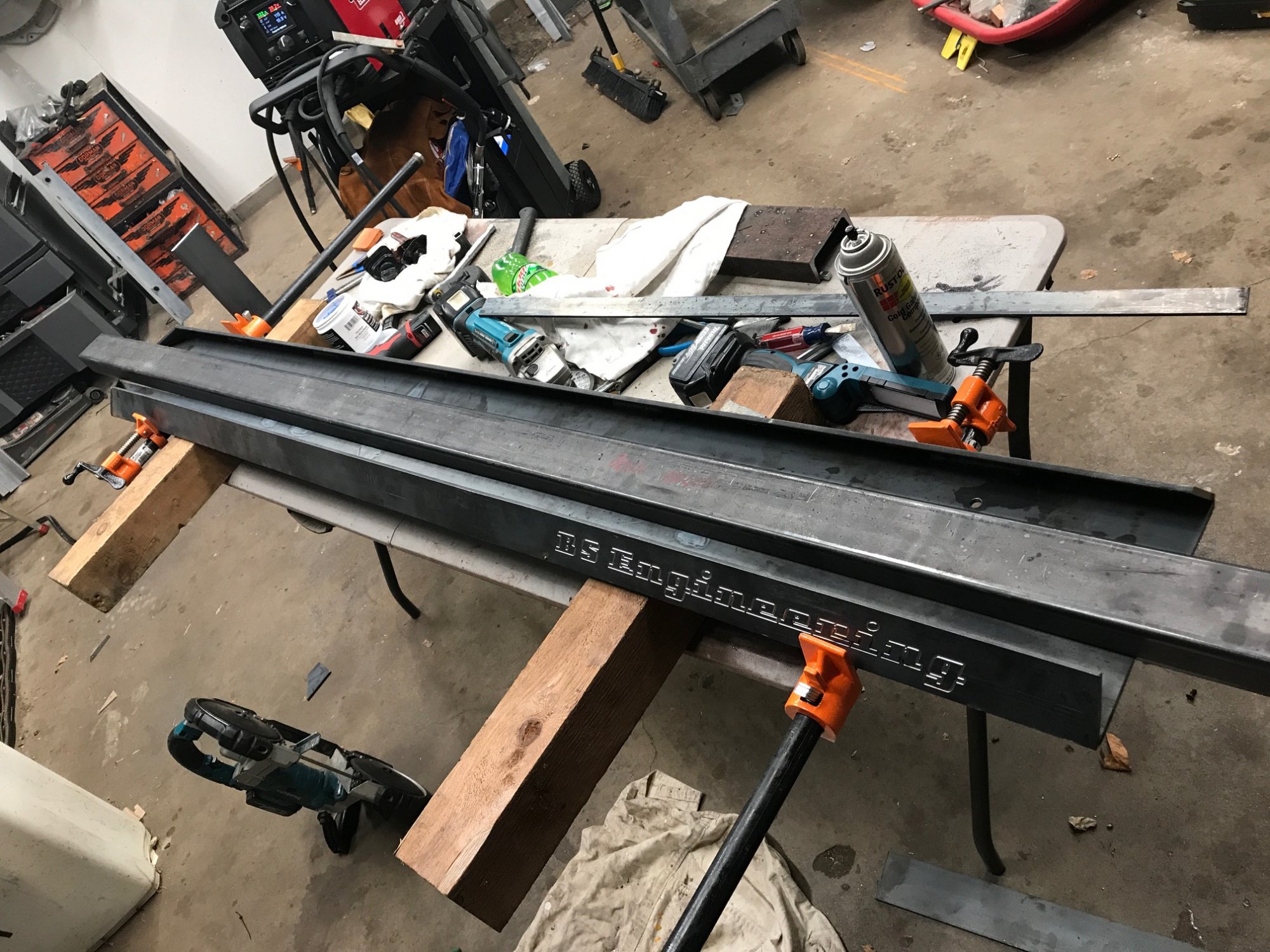

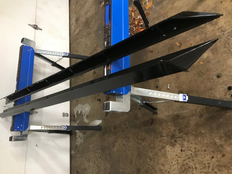

So so what your looking here is a set of bed rails I welded up last saterday, I'm going to bolt them on tomorrow. Will update pics. This is the first stage, I'll be working on a led light bar behind the cab run turn brake lights.

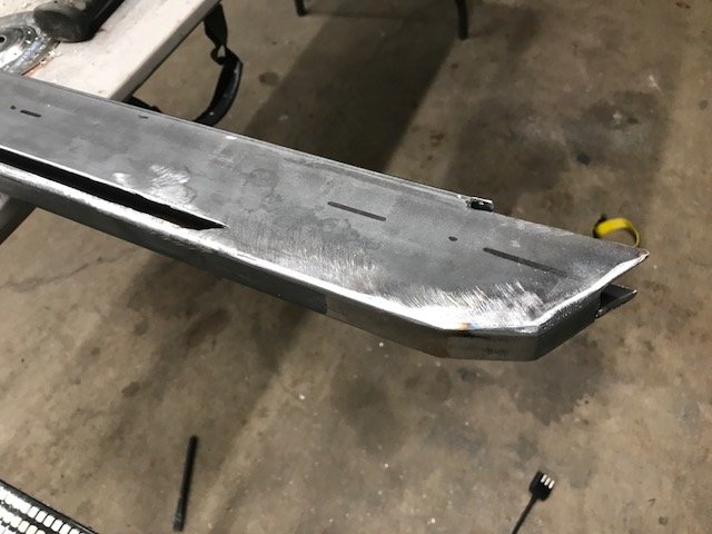

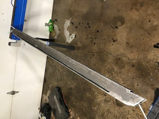

Kind of hard to tell, but in a nut shell. Between the bed rails above I took a opt 7 60 inch light bar, bought a 1x3 rectangular tube and cut a slot in it really carefully with a skill saw. Filed the ends for a taper instead of round. The light bar will shoot straight up in the  tube. I welded a flat bar inside at a angle to the light hits it at a 45 and reflects straight out the back. Capped the ends off and left one side open enough to get the bar and a 3/4 square bar in. Drilled some holes for drainage. I'm hoping to mount it tomorrow to drill holes in the rails. It will sit behind the cab flush with the front of the box.

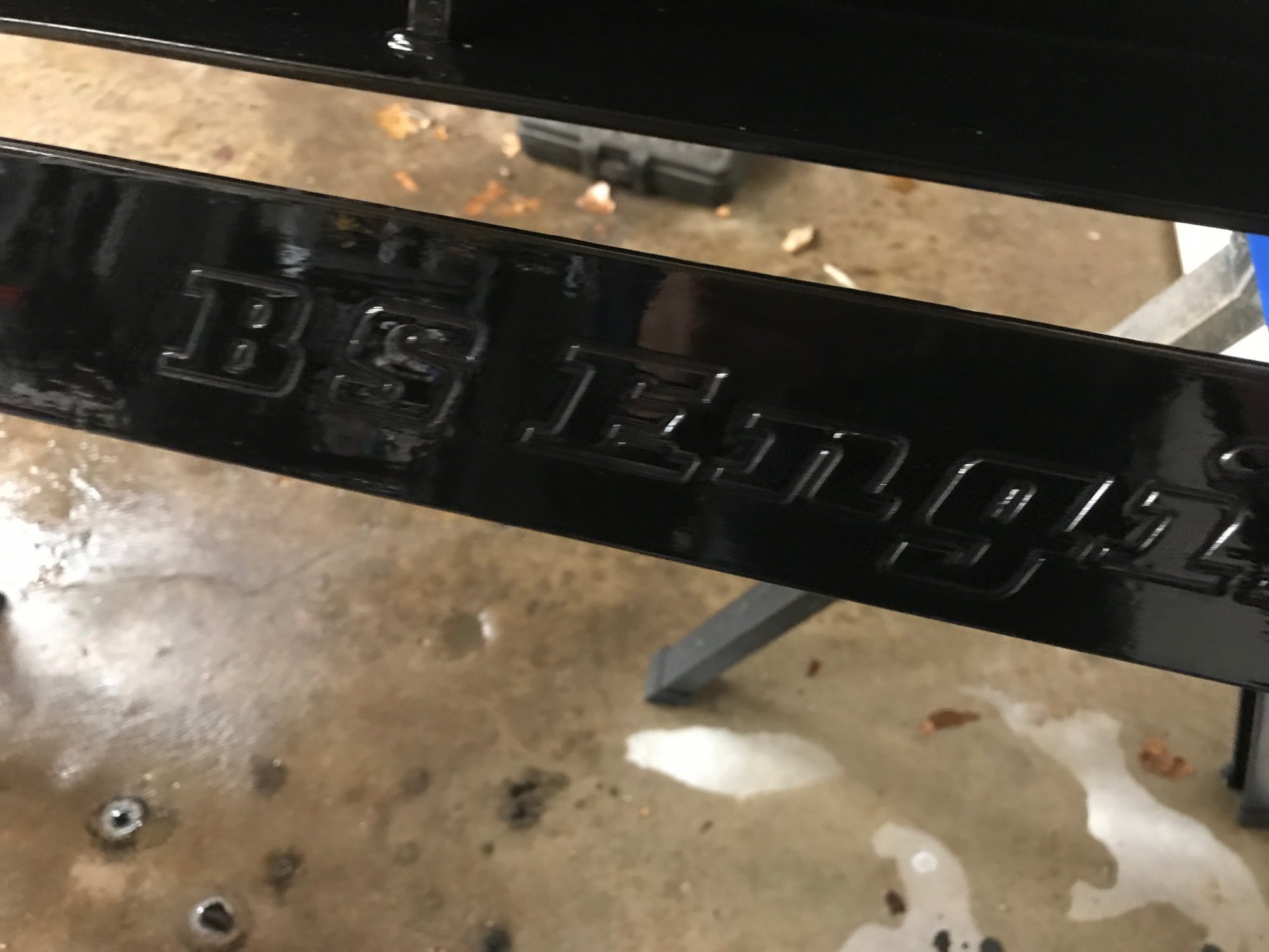

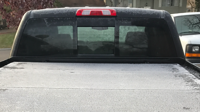

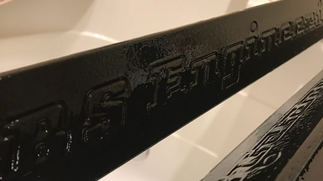

Mounted it behind cab, drilled holes for mounting to the bed rails I made, and prepping for por15

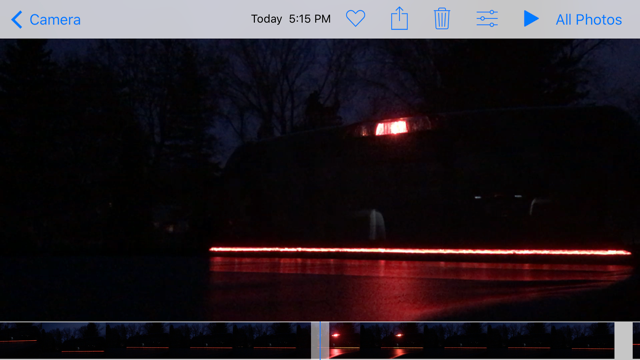

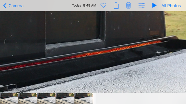

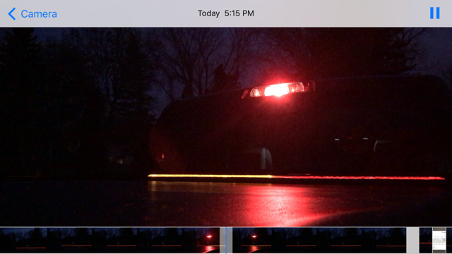

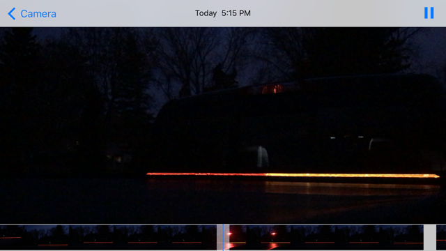

Light bar installed, need to wait till dark to see how it is
