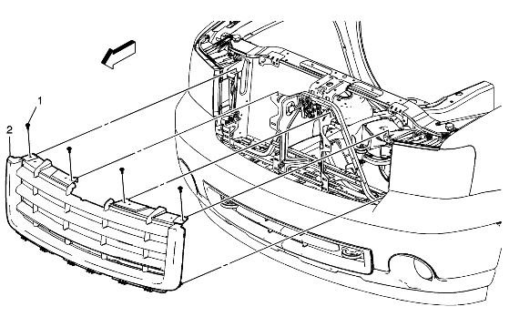

  1. Remove the radiator air upper baffle/deflector.
  2. Remove the front bumper fascia trim cap.
Radiator Grille Bolt (Qty: 4)
2
Radiator Grille
  1. Disengage the six clips by using a pair of flat-bladed pliers pinching the retainer tabs securing the grille to the hood stop and hood bumper brackets.
  2. Separate the radiator grille from the hood stop and hood bumper brackets by pushing the radiator grille outward away from the vehicle.
  3. Install the front bumper fascia trim cap.
