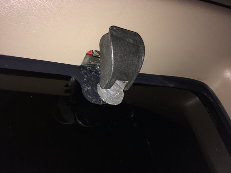

The latch part that is glued to the window has become broken off. I’ve searched the internet and have not been able to locate it. I’ve found the latch itself but not the part that attaches to the window.
Part of the glass. I have looked it up every way and even called my friend that owns the local glass company (Glass Works). They are called Quarter glass nuts.
At least it is an easy repair. get you a piece of good fishing line and cut out the urethane and stick in the new glass.

Or get you a piece of cutting wire and go to you're local pick and pull parts lots and snatch one off.
