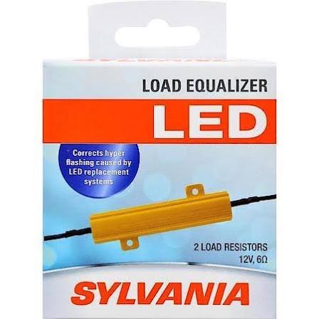

I got it to work by putting the resistors in parallel with the signals.
My next issue is that the led lights in the cargo lamps wont be bright unless i touch the resistor leads to the terminals of the lamps.  My problem is finding a place to mount the resistors to metal where they can dissipate heat properly.  Any ideas?

The resistors are inside the heatsink like the one pictures here.  You shouldnt use double sided tape to mount as that'll burn, so self tapper screws are what is called for.  My issue is i cant find anywhere to mount them.
