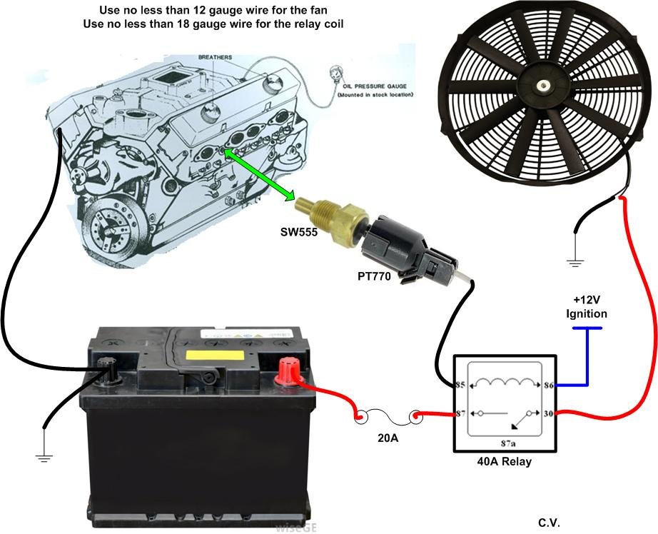

Another simple option is to unplug the fan, and ground 1 terminal, and hook the other terminal to a power source under the hood that is only hot when the engine is on.
Or you could do this:
 https://www.oreillyauto.com/detail/b/hayden-3856/cooling---heating-16773/cooling-fan-controller-module-11359/1a3fc21dfde5/hayden-temperature-switch/3647/4364642/2005/gmc/sierra-1500?q=fan+controller&pos=1
There are different models, and some are adjustable. You put the probe in the radiator, and then hook up the wires. Easy to install. It supplies power to the fan motor when the probe reaches a certain temp.  I have used them many times for various reasons.

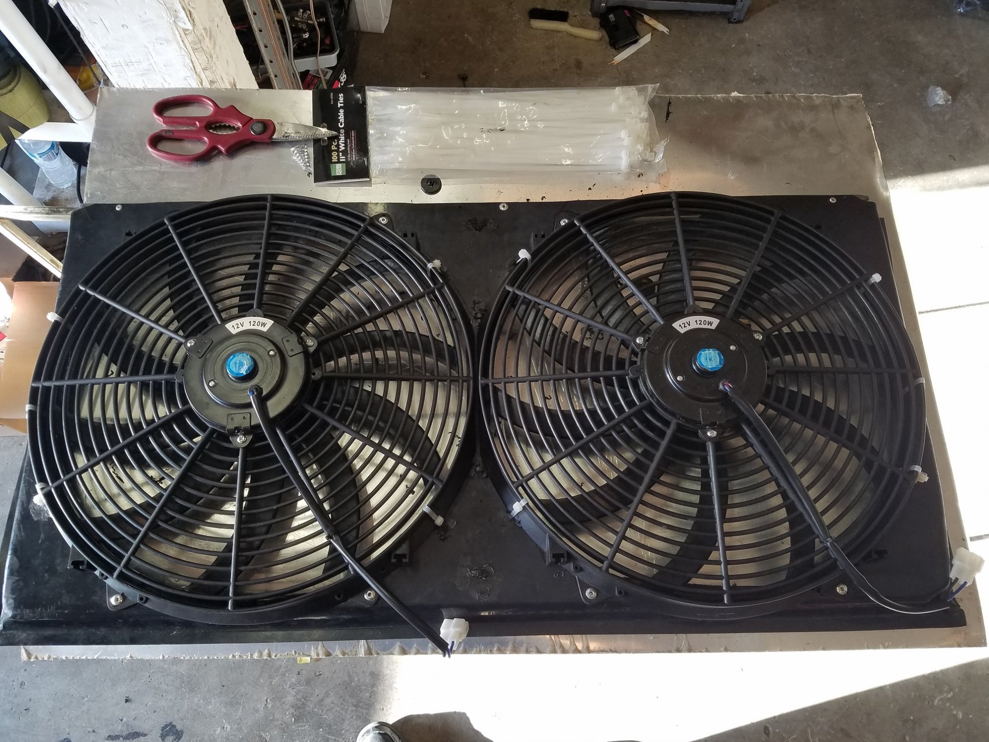

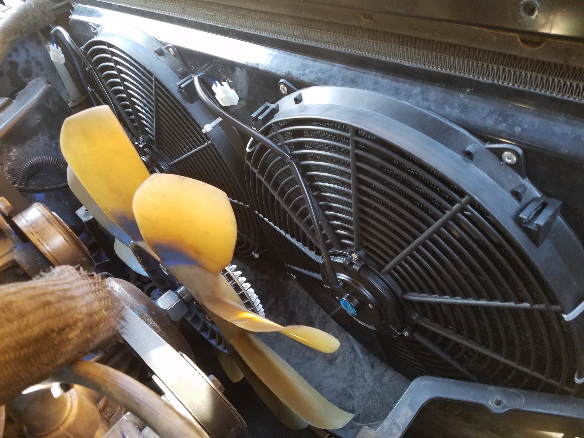

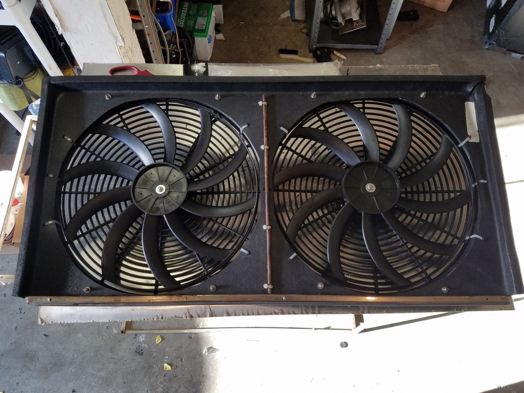

I have a 2002 Suburban that started to overheat once. It has a clutch fan, rather than electric. I replaced the fan clutch with a "severe duty" fan clutch, and then made a secondary fan shroud with 2 BMW electric fans, controlled by a Hayden fan switch. The whole setup was well under $100.

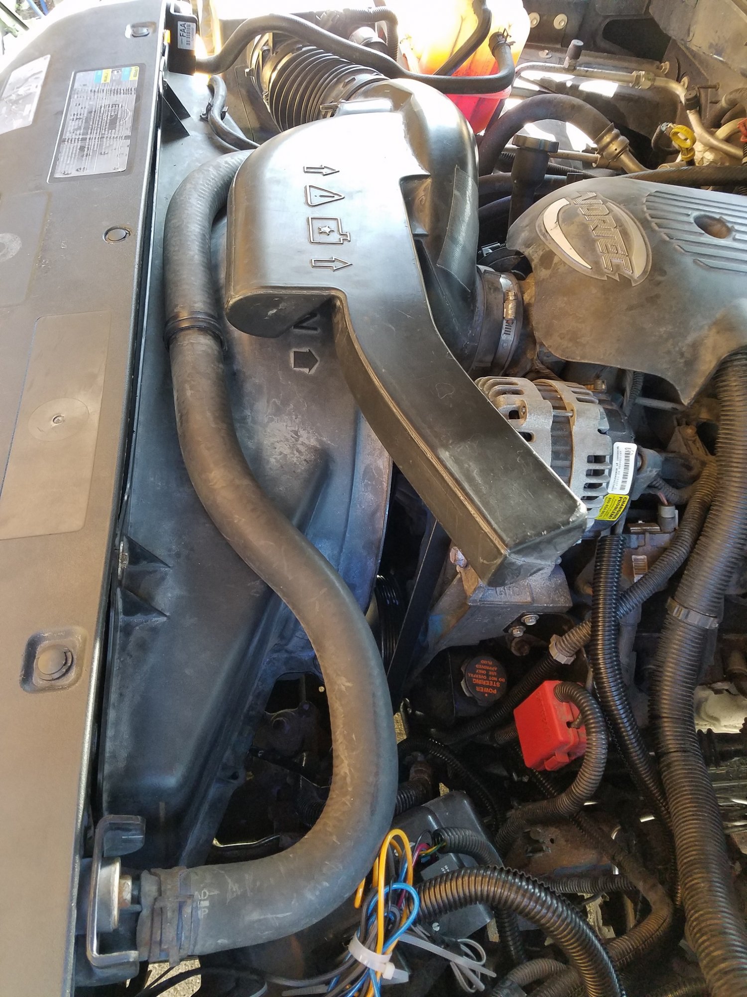

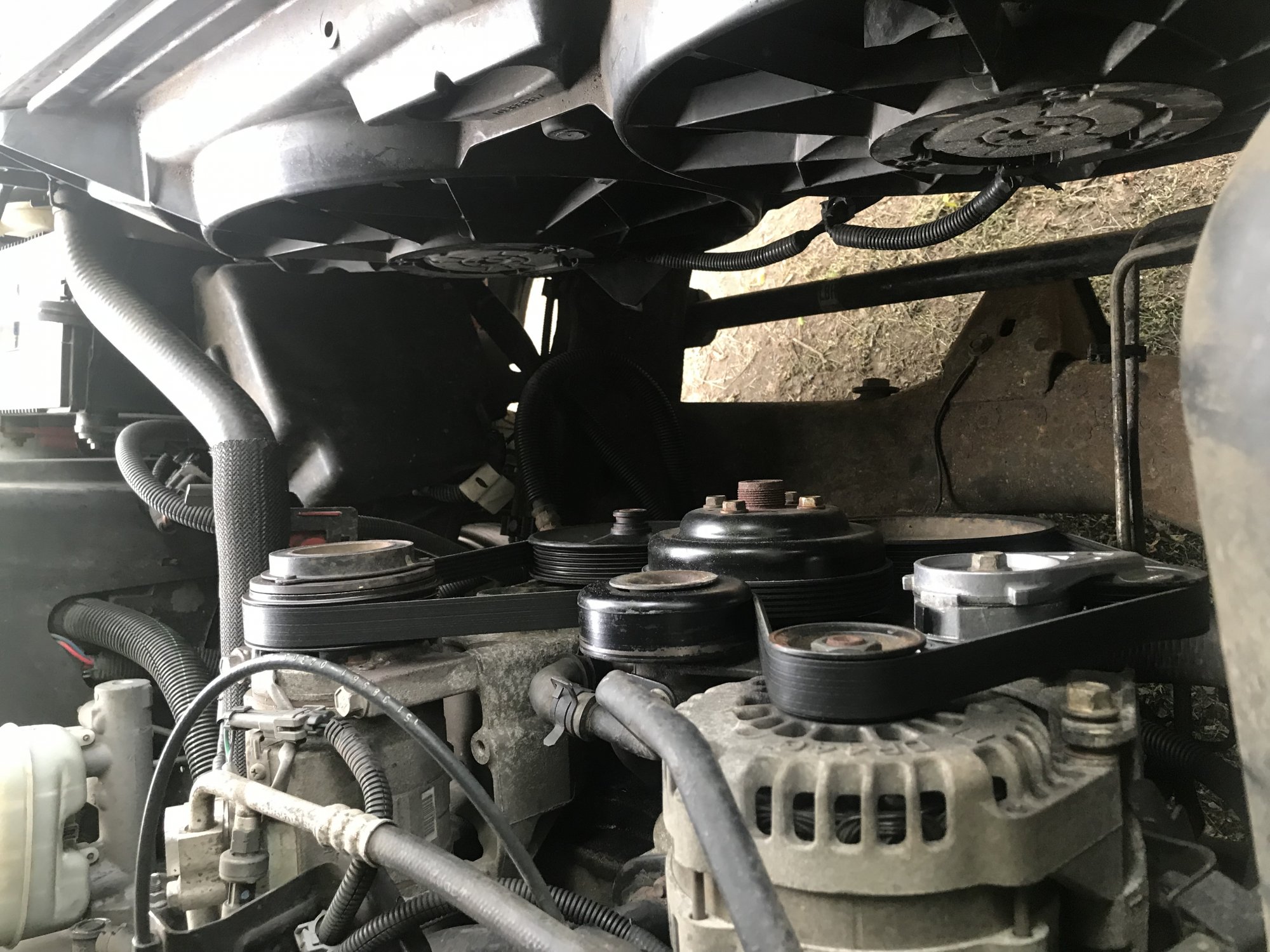

You engine is set up for a clutch fan. You could EASILY add a clutch fan and shroud. Junk yard parts - maybe $35 total. Install would take 10 minutes. The can treads onto your water pump.
My dad has the same truck as mine with the 4.3, but his is Chevy and he uses that for work every day, with a trailer. His truck would never over heat, even with the ac on. His is a clutch fan. I think the clutch fans were too good so GM stopped putting them in trucks, i believe. I wouldnt mind having a clutch fan but im going to try the temperature switch/probe and change out my engine coolant temp sensor
